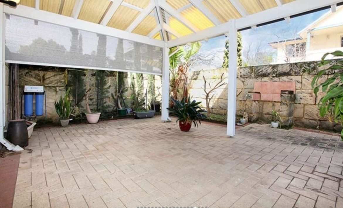

Would like to turn my 16m2 patio (attached to rear of the house) into an enclosed additional room- see pics
Due to labor shortage and other constraints, would take to take following sequencing
1. Concrete pad- to find concreter
Question- should this concrete slab be attached to the house structure or just a stand alone pad.
2. Change poly roof to insulated cladding-roof contractor
Question ; Any showrooms in Perth with different type to choose from?
3. Install power outlets
4. Install light weight insulated wall and doors-carpenter
Question: Do you think the use of those sandwich panels will devalue the price of your property? Will they continue to perform after 10 years?
