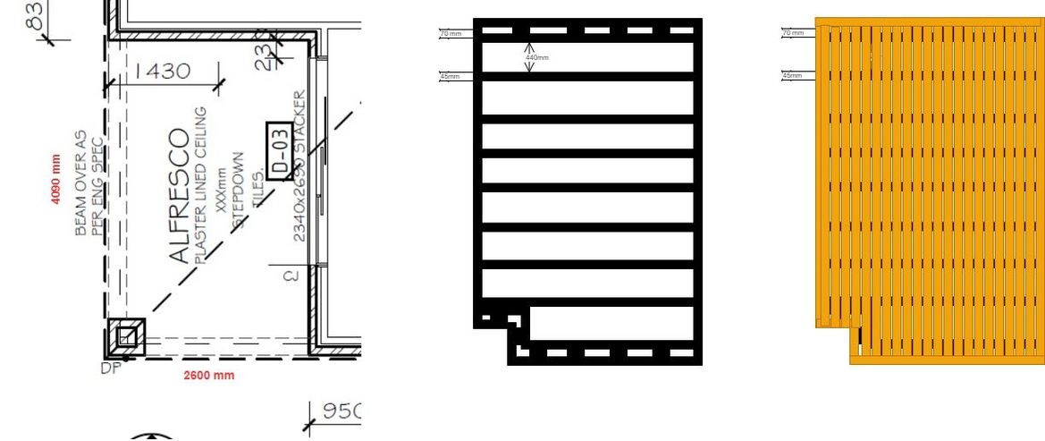

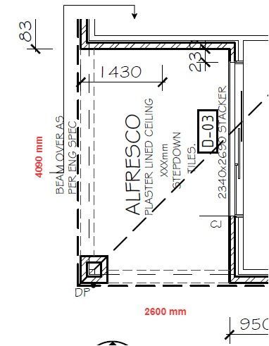

I wanted to build a wooden deck in Alfresco on existing concrete slab to sit flush is bricks. Size of the deck is 4090mm x 2600mm. Here are few questions:

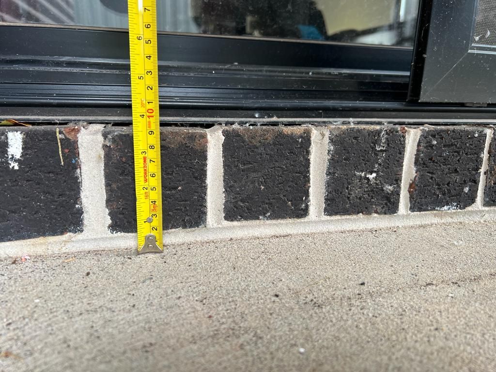

- I've to maximum height of 90mm to play around (refer attached picture). Is it even possible? My understanding is 19mm is deck boards and rest is 71mm. And there has to be at least 10mm air flow space under the deck(joists resting on galvanized brackets), that leaves me with 61mm. Can you please suggest/recommend what type/size of joists to be used?
