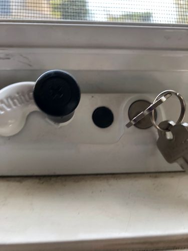

Lock button stuck down and won’t unlock with key. Tried suggestion of pushing button at same time as jiggling key, but still no movement of button. Is there a fix? Thanks.

If I recall correctly the locking button should pop up when you twist the key clockwise. One of the reasons that the button is held down is the winder has been over tightened and has pinned the locking pin in place. I suggest spraying the button and winder with WD-40 275g Lubricant with Smart Straw. Let the lubricant settle and hopefully it will be enough to let the locking pin slide out of the lock when you turn the key.
Another method you can try is to push the lock button down and turn the key clockwise. Keep the key turned to the very right so that locking pin mechanism is on the released state. Slowly lift your hand off the button and it should pop out.
If the key is a generic key for the other window locks in the house it should work. But if it is a dedicated key there is the possibility that this is not the right key for this lock. If you happen to have other keys in your possession, it might be worth checking if any of those keys are the right one for that window.
Please keep us updated with your progress, we look forward to seeing your window unlocked.
Let me tag our experienced members @TedBear and @tom_builds for their recommendation.
Hi @johnnikk , one addition,
if @EricL 's suggestions don't fix things could be, to get someone to push inward on the bottom of the window frame from the outside while you try to unlock it on the inside, in case the window has been closed too tightly and the pressure on the frame is jamming the lock.
Hi Eric,
Had sprayed with WD40 already so tried your other suggestion. No joy, sorry.
Thanks
Thanks @TedBear. Your suggestion also no joy. However good news @TedBear & @EricL, my son turned key with pliers and pushed button down with screwdriver and managed to unlock.
Good to hear that you've found the solution @johnnikk . Nothing like a bit of brute force...
@TedBear 's suggestion of pressing inward on the bottom of the frame from outside while trying to open the lock worked for me. Thanks! WD40 alone didn't help.

@johnnikk @EricL - I didn’t have keys to the house I moved in. So I just unscrewed the whole unit and remove the pop up button.
Hi there checking if I can take the whitco out, to try unlock as no keys ?

If you are planning to remove the entire assembly, I suggest checking the type of screws used to mount the window lock. If the anti-tamper screws were used it will be necessary to use a Sutton Tools No2 Easy Out Extractor Screw Set.
Once you have the screws out the entire set can be removed. You can then either attempt to find a compatible key or replace it with a new Whitco White Lockable Window Winder.
