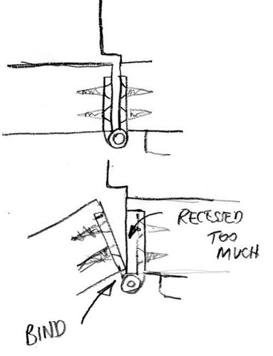

A hollow-core internal door was jamming in the frame on the latch side at the top. It looked as if the door was out of vertical so I recessed the top hinge further into the frame. Now the door won't close at all - it seems to be somehow too big for the frame. The hinge-side vertical frame component is proud of the panelling by 1-3 mm. I don't see how recessing the hinge could have caused the frame to expand but that appears to be what has happened. I could plane the sides down but I thought there might be some way to squeeze the door back to its correct width.
In the image, the left-hand white area is the panel, the brown area is the frame protruding beyond the panel, the black is the gap and the right-hand white area is the steel jamb and wall
Any ideas?
