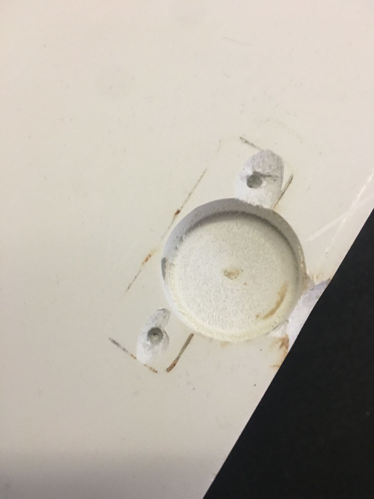

Hello! The door to my bathroom cabinet has come off... the area surrounding which the screw fits into has chipped away making the door unable to be reattached? How do I fix this problem? Many thanks!!! Emma.6A759867-DCAB-47FB-9F91-BE3A0D5EC9F1.jpeg

Knead-it to fill the screw holes, let it set and cure before redrilling the screw holes. Some people put the filler around the screw and push it in, I don't like it as it may mean more damage if you have to remove the hinge in the future.
