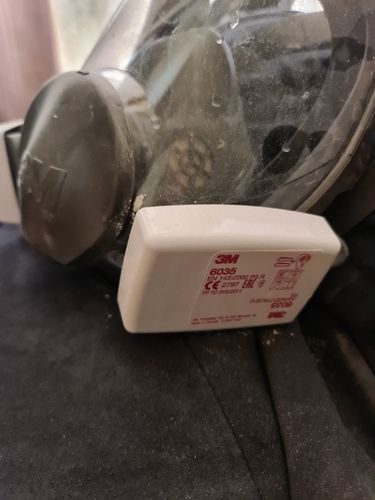

1- I bought expensive PPE as silica dust is no joke and I'm very cautious when it comes to my health, I've attached a picture of the 3M full face mask I'm using with the P3 filter cartridge attached...is this sufficient enough as the grinder i used didn't have a dust shroud and the dust was quite intense, couldn't see at times. (Hoping I didn't get exposed to any harmful dust or chemicals gridning walls & floors) 🤞

That 3M cartridge achieves a P3 rating when used with your full face mask. Even at P2, it protects against certain particles, dusts, mists and fumes such as sanding, grinding, cutting, drilling metal, masonry, wood and concrete. You are well protected with your current setup. Just remember the cartridge will clog up eventually and need replacement, or you'll start finding it hard to breathe.

Thanks so much for the prompt response Mitchell & the reassuring message on safety!! Greatly appreciate it 🙏
I was just making sure as alot of websites I've seen mentioning some REL value that cant be exceeded & i wouldn't have a clue on what 0.05mg/m3 is measured 🤷
So i got the highest grade which is P3 as that'll be my only line of defense as i didn't supress dust with water & a shroud.
