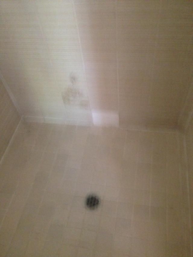

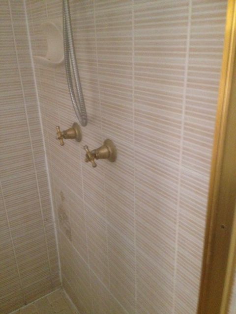

We have no money to spend on this dated bathroom to make it more appealing to buyers as we have to spend it all on the yard and retaining walls as it's on the side of a hill and I think the yard is why it hadn't sold however I am aware that bathrooms and kitchens are very important and want to give it a CHEAP facelift to make it more saleable. The toilet is behind the shower behind that door and there is a pair of louvre doors leading into the kitchen on the right-hand side opposite it. The main entrance to the bathroom where the picture is taken from is the lounge room. The photo makes it look a lot neater than it is. The door trim to the toilet is eaten away by white ants. Will post a couple of close-ups.cracked tilescracked tilesbad patch on tile wall of showerbad patch on tile wall of showermirror damagedmirror damageddated tapwaredated tapwareb4.jpg

Wall tiles:- Replace any wall tiles that are cracked if possible, otherwise fill the cracks and chips until you cannot see or feel them.  Paint tiles with White Knight tile paint and follow all of the preperation directions.  Use the colour white - it is not as quickly identified as tile paint and is accepted by the wider market at the point of sale.  The same with the bath - paint it white (spray for best result)
Shower frame:- Re. the shower frame.  You can paint shower frames with a Rustoleum product, but the paint always scratches off where the tracks are. So if it were me, I'd leave the shower frame as is.

Replace the taps, vanity door knobs, towel rails with new black taps from Bunnings.
