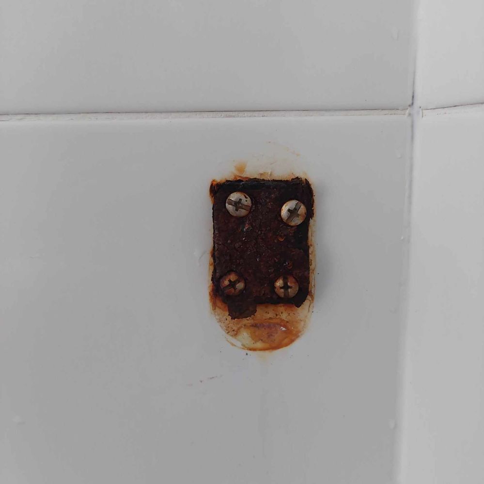

Rather old shower that the mounting plate clips have rusted away.

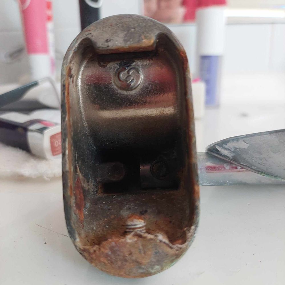

Can I get replacements I don't seem to be able to see any branding on the soap dish pictured.
Hoping to find something to fit same space as do not want to have to re-fix with something different.dish top view
dish rear

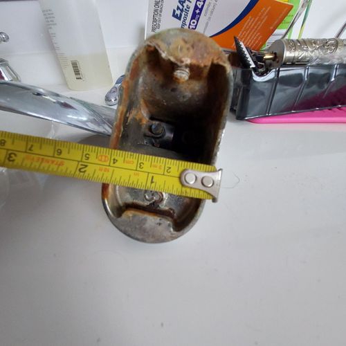

Apologies for the slow reply, but could you please share the dimensions of your soap holder? It might help our resident Bunnings D.I.Y. experts provide a suitable replacement from the Bunnings product range.

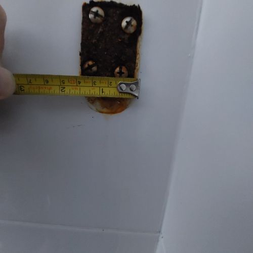

I have attached images with the mounting plate I want to I guess cover and use the already pre-drilled holes into the tiles.
Looks like maybe the plate has some sliding type as the screws in the wall appear to be at different heights.
So maybe anything that has centres for the holes around 10mm from top and bottom and maybe 10mm from either side edge?
Also added one image that shows the width of the soap dish.

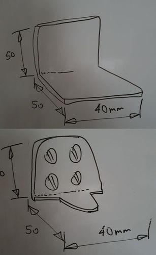

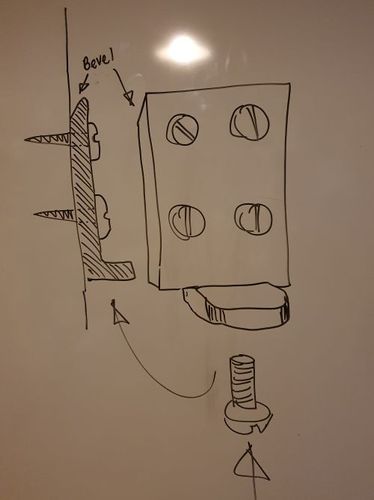

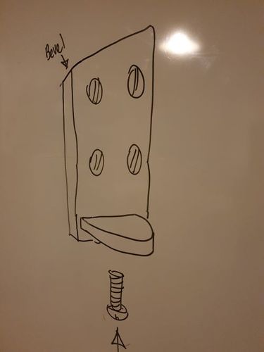

Quick amateur whiteboard drawing (the UFO seen at top right is kitchen light reflection) but possibly the original bracket looked something like this?
The beveled edges of the bracket and base would interlock at the top and the bolt/screw would pull the base down when screwed against the horizontal lip.
Your tape measure looks like the plate is 40mm in width.
To me it looks like we could fabricate a new bracket. I'd love to try.
EDIT - Sorry, it really is badly drawn...
A little better...
Of course, my interpretation could be completely wrong.

How good is this drawing thank you ![]()
I think you are spot .... we found a couple of rusty pieces from the back plate but not sure if they are both from the bottom or top or top and bottom extrusion (right word).
I am going to have to ponder for a while to see what we may do ... I might remove the plate seal the holes with sikaflex and see if we can do something about the plate or match a sizing somehow once removed.

Certainly a much simpler solution. My thought would require an angle-grinder and bench-grinder and a lot of patience.
Breaking it down possibly from 50 mm angle-iron. All the best for your re-attachment. 👍
(I got rid of the UFO)
