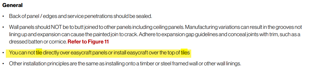

Unfortunately, no, you couldn't. Our main supplier for VJ panelling is EasyCraft. On page 14 of their Product Fact Sheet & Installation Guidelines it states -
VJ panels need to be glued and nailed to the studs. This would not be possible with tiles in place.
Unfortunately, if you wanted to install VJ panels in your laundry, you would need to remove the tiles, which would likely have implications in terms of waterproofing.

Based on the information in the current Easycraft installation manual, the information Eric originally provided in the other discussion was not correct. We have amended his reply. Please note that if you were using the Easycraft product in this fashion, you would not be covered by their warranty, as it is being used outside of its intended use.
Under the National Construction Code Part 10.2 Wet area waterproofing, a laundry is classed as a wet area, and any wall linings need to be water resistant, meaning you would need to use the easyVJ100 Wet Area Wall Lining, which is the wet area variant of the VJ panelling.
If you were set on changing the wall from tile to VJ panelling, I would suggest you speak with a professional for their assistance.
