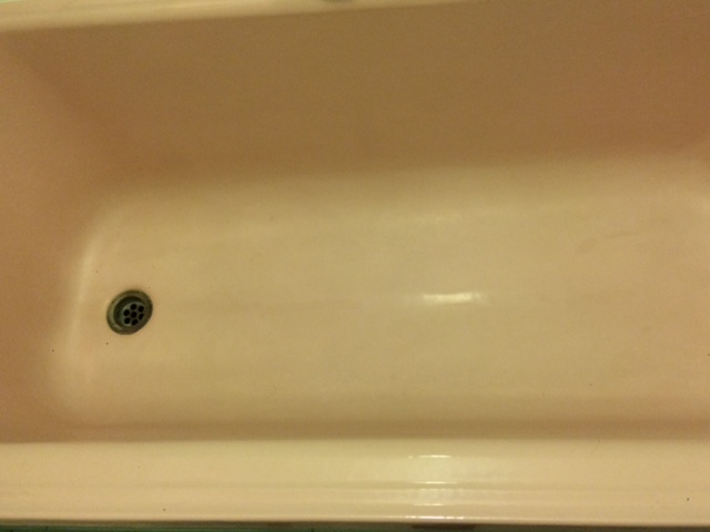

We've got a pink bath in our place and I hate it. We've had people say you can get a bath re-enamelled but I wondered whether you could DIY. Could I paint it myself? With what? How would I stop it chipping off? Thanks, Luke
Here's a pic
