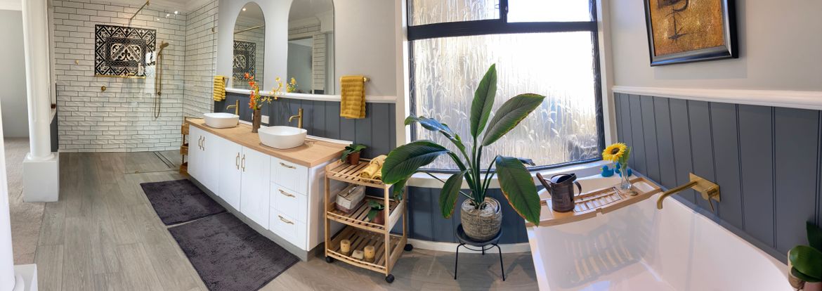

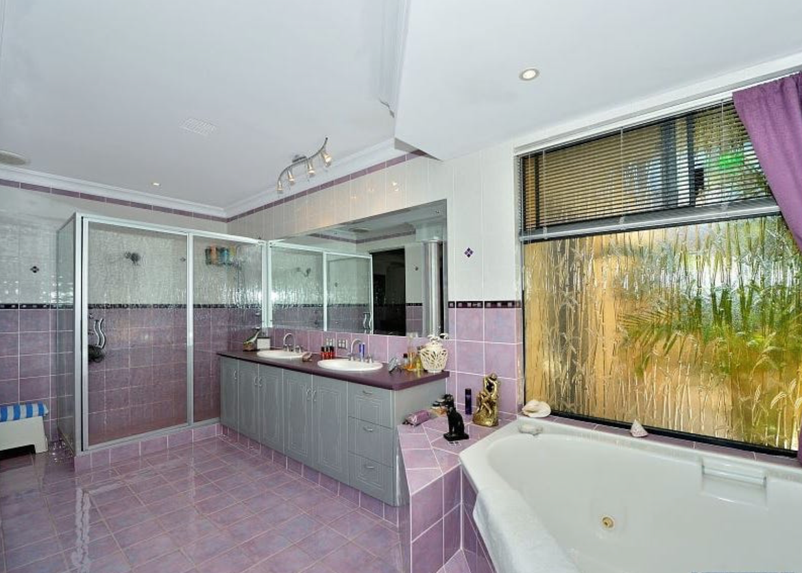

Completed Reno (panoramic piccy)Project was complete Reno of original ensuite bathroom. Replace highly glazed slippery wall/floor tiles, plaster upper half of wall after tiles removed and line walls with wall lining, Dado Rail and skirting boards. Replace shower screen and redesign shower area, Remove the huge spa and supporting walls and add replace with Bath Tub. Replace bench top, sinks, tapware, mirror. Frame windows. Paint vinyl wrapped cupboards. Before photo shown.

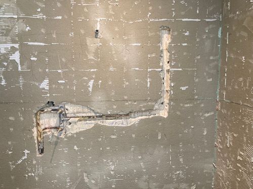

Remove existing tiles with the hammer drill.
Remove the spa body and the supporting brick walls (sledge hammer and hammer drill).
Re-locate the spa drain to accommodate the Bath.
Re screed the floor and shower area where required to ensure adequate fall.
Plumber re-locate taps for the shower and bath.
