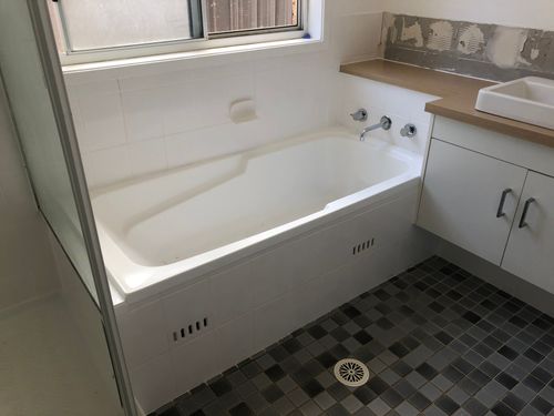

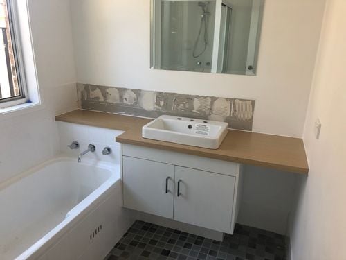

I ended up deciding on an even more purely cosmetic budget reno & have just completed this with White Knight Tile Paint, Mondella taps & other fittings, Methven Shower Rail & Caroma 3 taphole basin (just working with the existing plumbing & plumbing set up so not cost involved in that, just a simple tap swap out). We will install Mondella mirrored shaving cabinets across the wall, white hexagon tile splashback, and we had a Polytec bench custom made and just installed this morning onto the existing vanity base (so basin taps and waste not yet connected), which brings me to my current dilemma.

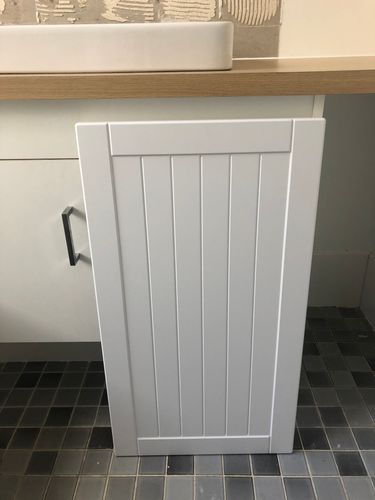

I ordered 2 x 400mm wide Kaboodle cabinet doors in Country Profile (Nougat Truffle) which are a Special Order, as I love the look. I knew the height of them would be almost to the floor but after bringing them home & putting them in place, I just think they’ll look better at least a little shorter (height of the vanity cupboard base is 500mm, Kaboodle doors are 720mm), maybe 550-600mm to height, but as Bunnings can only cut the Modern profile to size, getting them customised wasn’t an option.
Just wondering if anyone has had any experience/luck customising these themselves. Was thinking I could cut them down and then seal them with the White Knight laminate paint, but feel nervous attempting it without hearing some success stories first.

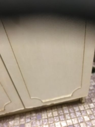

Just to confirm, as I wasn’t very clear, I’m happy to lose the top and bottom strips as I love this look (hopefully I can get the photo to upload), so no need to worry about reattaching parts, just more about trying to finish those cut edges and without it looking nasty. Obviously bottom isn’t such a worry, but more top, and also any effect on the front. 
