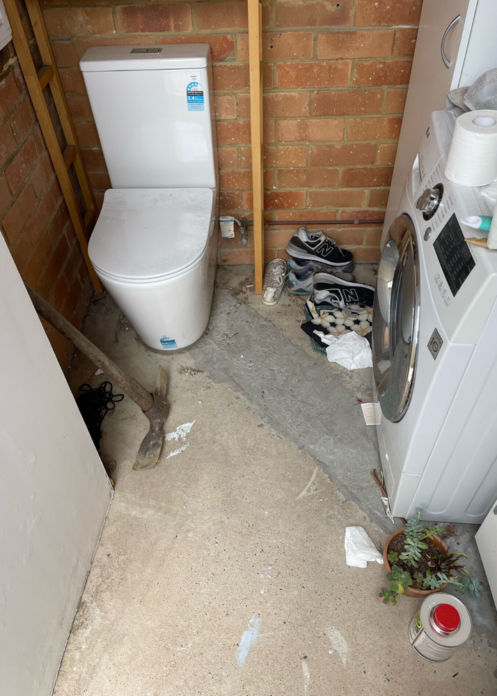

I am going to get my hands dirty and renovate my laundry floor which is concrete and uneven. I went to local Bunnings and got Dunlop 20kg Ardit Floor Leveller however I didn't get a primer as no one mentioned it to me and I just found our by reading the instruction. How important is using primer? can I avoid it to save money? Have I picked the right Floor leveller for my project? I want the laundry floor levels as close to the outside tiles also direct any water from laundry to outside (backyard).
I have leftover tiles from bathroom renovation 60 cm * 60 cm and 1cm thickness that I want to use for laundry floor and I am not sure if it would be easy to install for someone who hasn't done tiling before and if I should buy smaller tiles? Can you please help me with material I can use for gluing tile after floor levelling as well?
I removed the toilet and cleared the floor from dust and dirts.

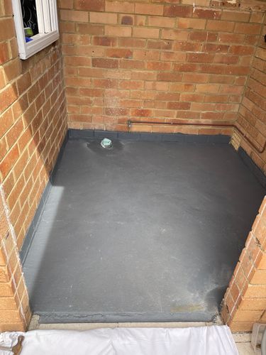

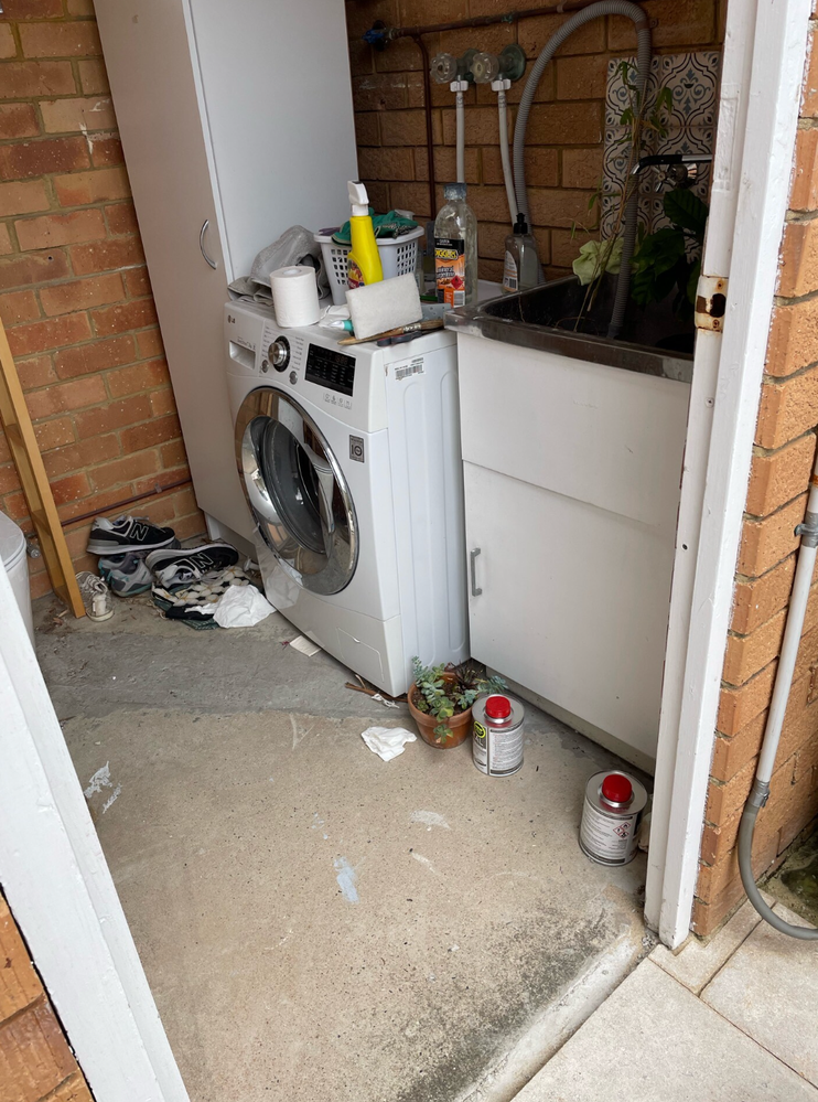

Looking at the photo you posted, how high is the tile outside of your laundry room? This can serve as a guide for you if you're trying to match the tile level outside. Since the tile you'll be using is 10mm, just keep in mind that you'll be laying down the same thickness of tile adhesive on the floor.
In regards to the primer, it's best to follow the manufacturers recommendation when using their product. Before you begin any major works, I suggest visiting your local council and having a look at the rules and regulations regarding your laundry revamp.
If you are tiling the whole floor, I suggest removing your pantry and the rest of the appliances in that room. Waterproofing will be necessary, and you'll need a certified professional to put it on for you as it will be signed off. Once the waterproofing has been applied you can then begin tiling your floor.

In regards to the fall of your floor, I suggest using a Craftright 1200mm Spirit Level to determine which way your floor is leaning to. I then recommend using a builder's line as a guide when using the leveller. If you've never done any tiling, it would be better to use smaller tiles as it is easier to manage and adjust.
Since you are tiling onto a concrete base, I suggest using Dunlop 20kg Trade Resaflex. It is a multipurpose rubber modified tile adhesive and works on walls and floors. You can use it over a range of surfaces including Dunlop waterproofing membranes.
