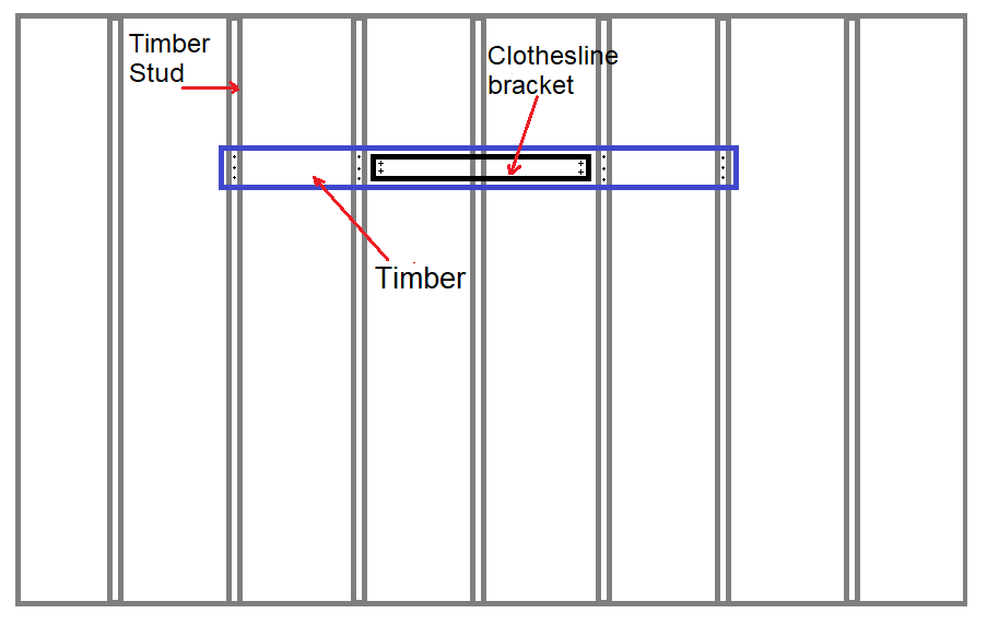

@vikingwench,
 As @Iain was mentioning, a good solution would be to bridge between the timber studs with some 90 x 35mm H3 MGP 10 Treated Pine Outdoor Timber Framing. You can then fix the clothesline bracket to the timber. Here's a rudimentary diagram to illustrate.
