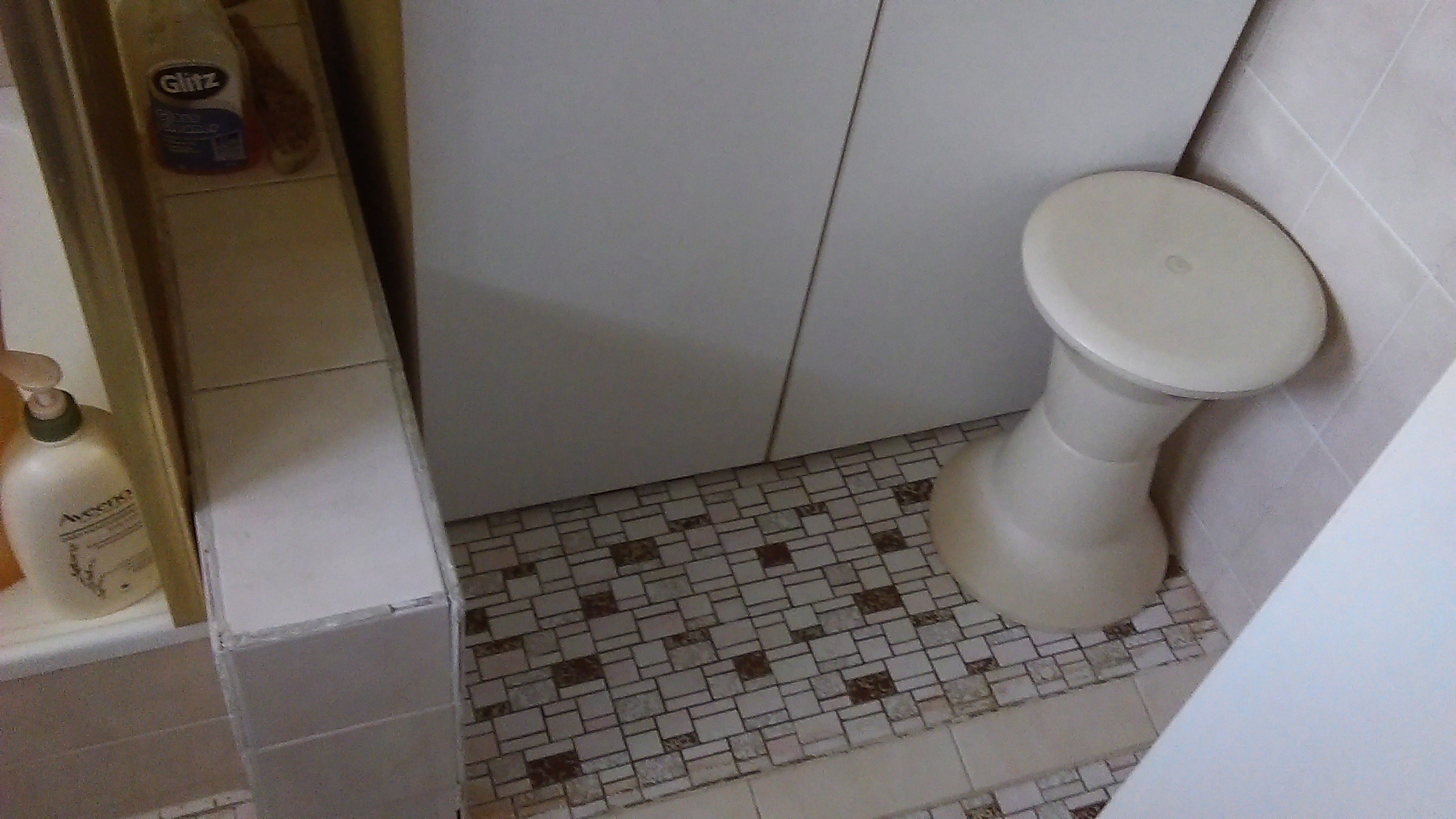

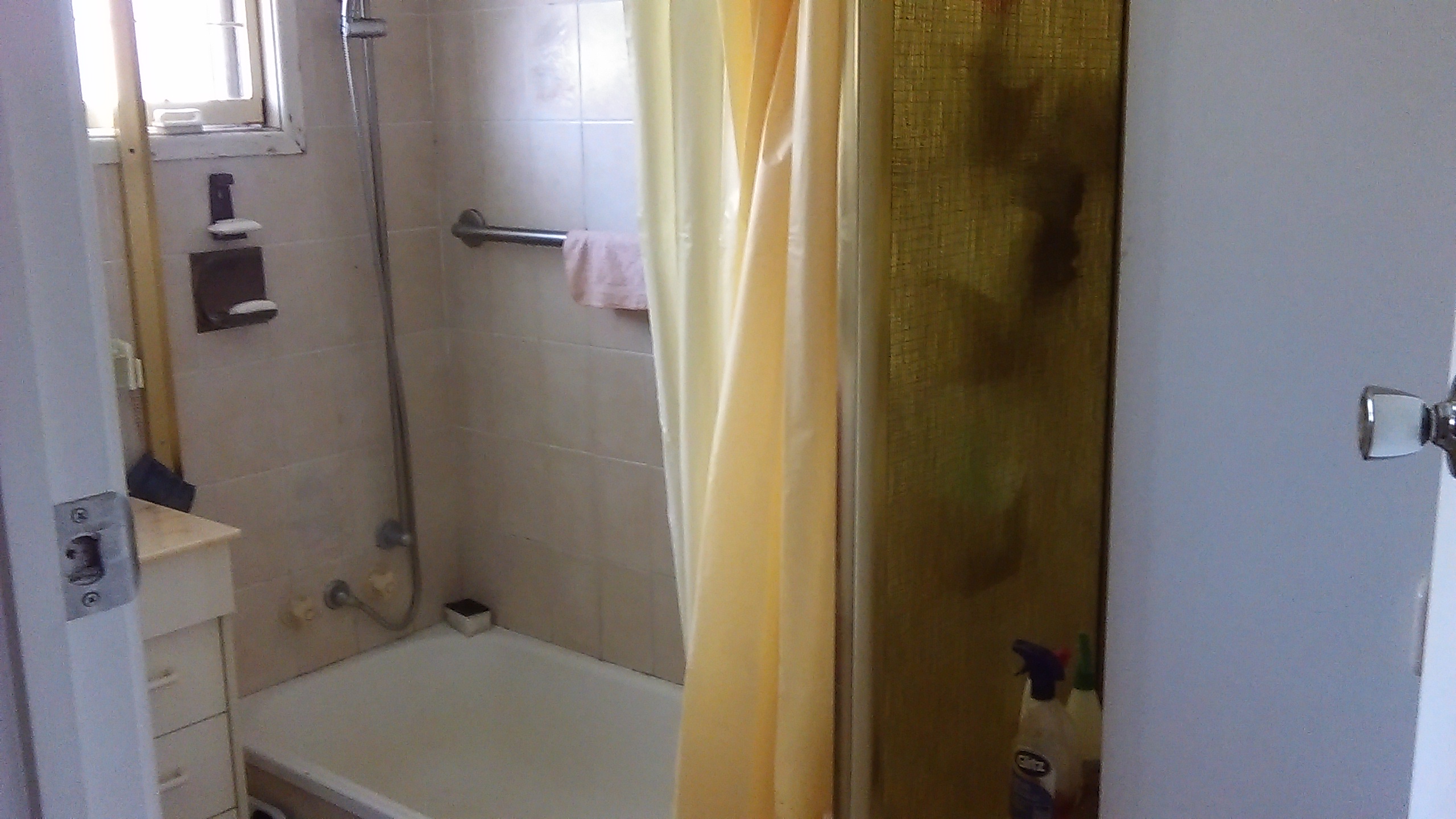

Here are the pictures of the bathroom. The shower used to be where the cupboard is in the second picture, so that's already plumbed (I don't know about waterproofed) and the bathtub waste is to the back of the house above the garage and laundry.
