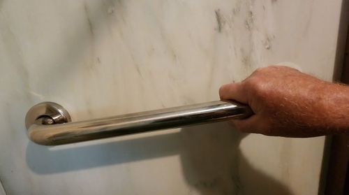

I was thrilled with my handrail installation this morning. 😁
Caroma product.
Cheers.
