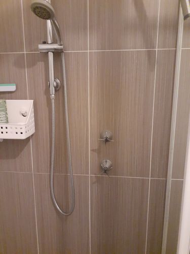

How to change shower taps to shower mixers?
NormaMary
New Contributor
How to change shower taps to mixers

Not really a diy job. It requires cutting and changing of pipes in wall behind existing taps. Really a plumber job and then you need to retile the area they had to remove to get to the pipes.

It's great that you've received advice from @JDE. If you are wanting to replace the existing shower set, the tiles will have to be removed and the services of a registered plumber will be required to install a shower mixer.
However, I also recommend an external set like the Quoss Reno Transformer Freestyle Shower Mixer. The Reno Transformer Freestyle Shower Mixer product transforms your old 2 taps into an exposed single flick mixer system. Installation is an easy retrofit with no extra work such as breaking the tiles, drilling holes in the wall, plumbing, or piping.
Here is a link on how it is installed:
If you need more advice or information, please let us know.

Thanks Ericl I wish I had known about these before I worked on my daughter's shower. Do they have one that allows you to use existing shower rose or do you have to fit a new shower rose system? JDE

I'm glad that information helped. The Quoss Reno Transformer is actually very handy and is a more affordable alternative to a shower mixer renovation. Yes, you can use your existing shower rose and hose if it is the exposed system on a rail. It has a standard shower hose fitting at the bottom of the mixer itself. However, the one behind the wall will have to be closed off at the top. This is a great alternative when trying to modernize an existing fitting in the shower.

This is even more clever than it originally looked @EricL  .... I downloaded their brochure and there is a rail system that screws onto the old shower-head outlet, thus sealing it off while also providing the vertical rail to hold the new head, without requiring any drilling into tiles.
I can see in @NormaMary 's situation they can just swing the existing shower hose over to the mixer outlet and buy a chrome cap to seal up the outlet at the bottom of the existing vertical rail.
