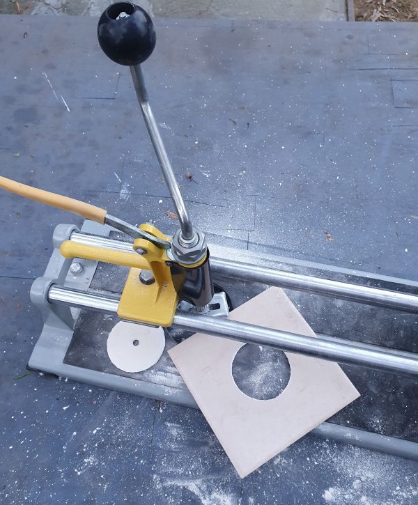

More than likely it was a gimmick that I got suckered into - but an attachment to your typical two-rail tile cutter. A pressured cutter that you spin by hand.
Cheap. Sizes from 30mm to 80mm diameter.
Slow.
And loud (screeching) - dogs two blocks away start barking.
But it does work.
A concept still around?
The hole-saws above look a much better alternative.
