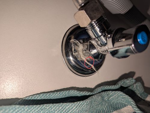

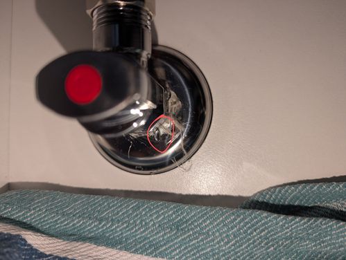

G'day,
I've just moved into a new place and noticed a slow leak from both the hot and cold water inlet pipes under the laundry sink.
The leak continues even when the valve is turned off so I imagine that the leak is between the valve and the wall.
It appears that the previous owner (a plumber) has tried to fix it with plumbing tape but a small leak still persists.
Is there any DIY solution that I could do or is this a job for a plumber?
Cheers!

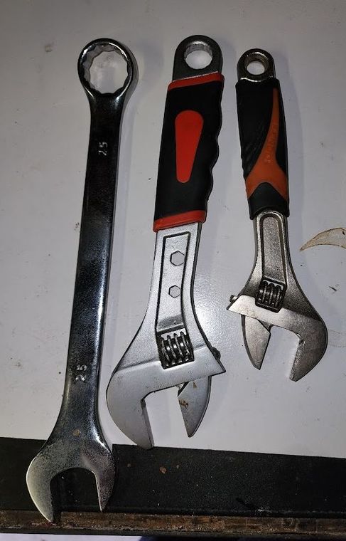

Was it a shifter or your 'fair-dinkum' spanner? 😁
I experimented with my sink mini-taps and a 25mm open-ended spanner fitted perfectly. Being 25mm it is just over 300mm in length which means more leverage than an 8" shifter or even a 10" shifter.
Let's hope your WD 40 works.
But just a leverage thought.

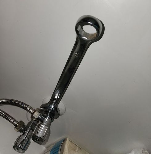

It's great that you've received excellent advice from @Noyade. Just to add to the suggestions made, I recommend placing the spanner on the other side of the wall so that you are applying your force downwards instead of upwards as indicated in your photo. Another option is to firmly tap the spanner on the handle with another spanner to create a momentary force to shock the fitting loose. If after several hits no movement occurs, I suggest stopping and not forcing the issue further.

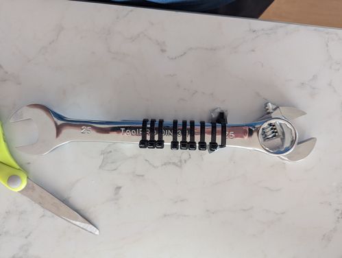

Seems like leverage was the trick!
Unfortunately my 25mm spanner was a millimetre too small so MacGyver came to the rescue with zipties and duct tape to give me the extra leverage on my shifter.
Valve refitted with new plumbers tape and is looking good!
