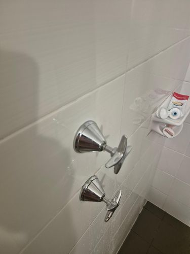

I have tried a strap wrench but can't seem to get the grip on the angled tap housing

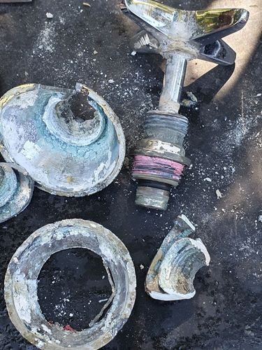

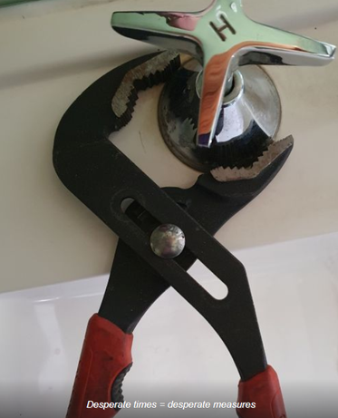

This is a fairly common issue that we've seen on Workshop a number of times that is difficult because the angle on the flange plate doesn't allow any tool to get a great grip on it without damaging it.
It can become stuck for a number of reasons including the use of silicone to fix the flange in place or scale buildup over time. Unfortunately, there is no one perfect solution.
Please have a look through the following examples:
Some potential solutions are:
Ultimately, if everything else fails, you may need to crush the flange to remove it. This would mean it can't be reused and you would need to replace the taps.

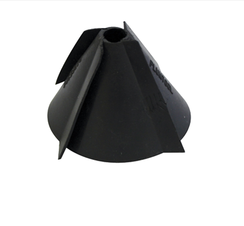

Hello @andrewr10 🖐To maximise working space, you're best off removing the handle's grub/set screw so it can be withdrawn off the spindle, then it's just you and the bonnet/cap/cover... a strap wrench is a great idea, thus far I have been lucky enough to remove this component using brute strength alone, clearly this has caused some grief as I note someone went to trouble to design a removal tool.
