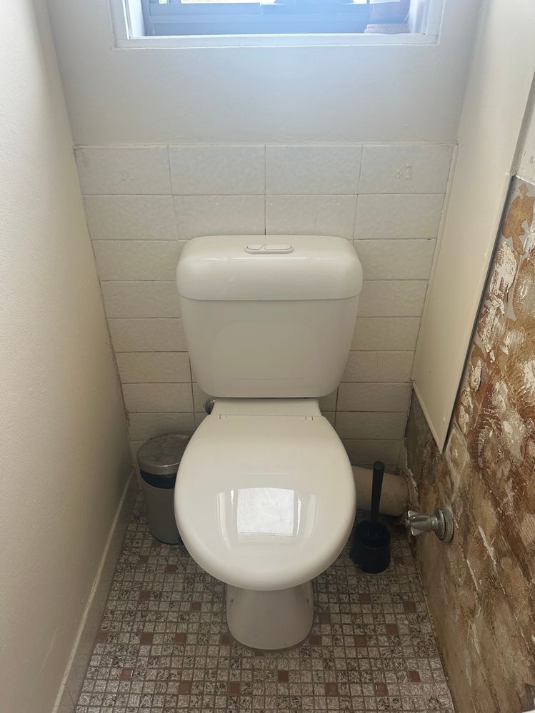

We are looking to re-do our toilet (tiles have already been ripped off the wall).

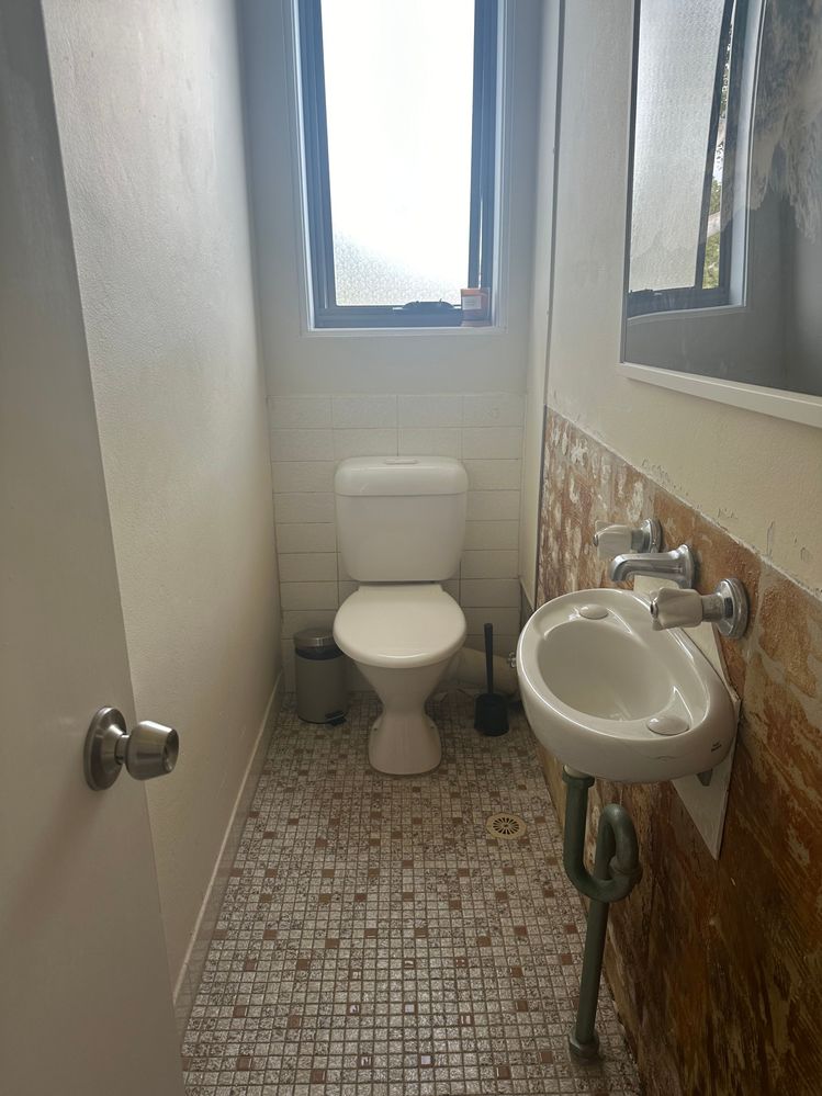

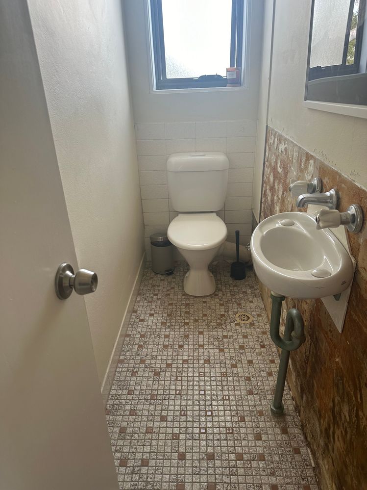

We are trying to figure out how to to hide a right hand skew toilet pipe with a DIY wall to create a shelf above the toilet, and what sort of toilet we would need? Wall hung? And how we could look to replace the pipe from the sink, I don;t mind it being exposed but I would like it to be a brushed gold? Any ideas and recommendations would be super helpful! thanks

My apologies for the late reply. Depending on the available space, your right-hand drain can be converted into a "P" trap set. It will require the pipework to technically make a left turn allowing you to use a standard "P" trap toilet. I propose speaking to your plumber and asking them if there is enough space for the conversion.
I propose looking at the Mondella Concerto Back To Wall Rimless Toilet Suite. This is a universal toilet suite and can be installed in an "S" or "P" trap configuration.
In regards to the waste pipe finish for your basin, I suggest thinking about running it through the wall and down into the floor. The cost of replumbing will add to the budget, but it will give you a much cleaner look. However, if it is outside the budget, I suggest using White Knight 300g Metal Guard Spray Paint to colour the pipework.

To deal with the pipes to your sink, have you considered replacing it iwith a pedestal style sink instead?
