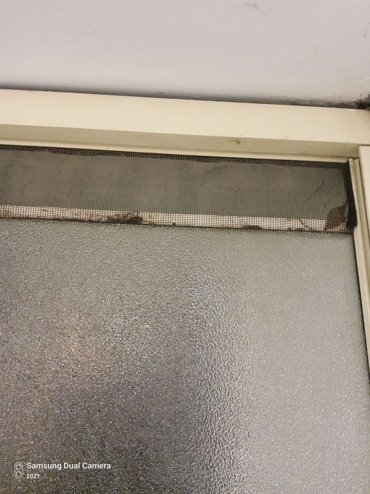

You know those 7cm ×35cm mesh which serve as air vent and fly screen but couldnt prevent dust coming in ,bring in heat in summer and excessive chilled weather in winter. I have been trying to put filter material over it to prevent dust but would like to know how others managed it.
They come with older house and seems to be fixed.
Any idea what easy options do i have?

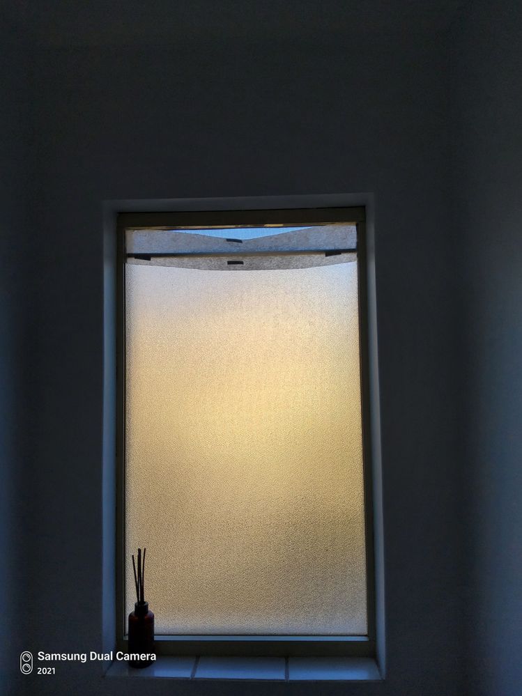

Hi @Onearmman,
Any chance we could get a slightly clearer image of the vent/flyscreen? One with the light on might be sufficient.
Would you be open to permanently sealing it and installing an exhaust fan to compensate? Filter material will certainly prevent dust from entering, but I'm unsure how successful it would be at preventing heat/cold transfer. I'd imagine not very effective. Perhaps we could even design some type of panel that's fitted over the filter mesh when extreme temperatures are present and removed when not.
I am looking forward to further images. Once we have them, I trust our knowledgeable members will have plenty of advice for you.
Hi, Here is another photo. Hope this is better.
Many thanks for the additional image @Onearmman. What were your thoughts on closing off this vent? It sounds like it's causing more drama than it's solving.
Personally, I'd recommend cutting some plywood slightly larger than the opening, painting it with exterior paint and then screwing it onto the exterior side of the frame to cover the gap. An exhaust fan would then be installed to provide ventilation.
Let me mention @TedBear, @Noyade and @JDE to see if they have any thoughts.
Hi @Onearmman I agree 100% with @MitchellMc
Those old vents are barely effective anyway since there is no flow of air which is needed to remove smells or condensation.
I also recommend that you block it over as suggested, or get a glazier to replace the glass with a full length piece (the more expensive option). Then install the fan.
