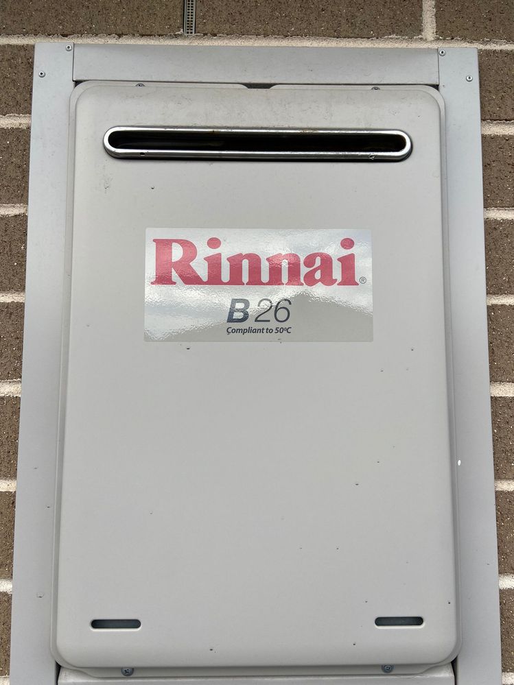

Here are the information in relation to Water Heater and Mains Water. Do I need to contact the water heater vendor for infering the flow rate of the equipment.

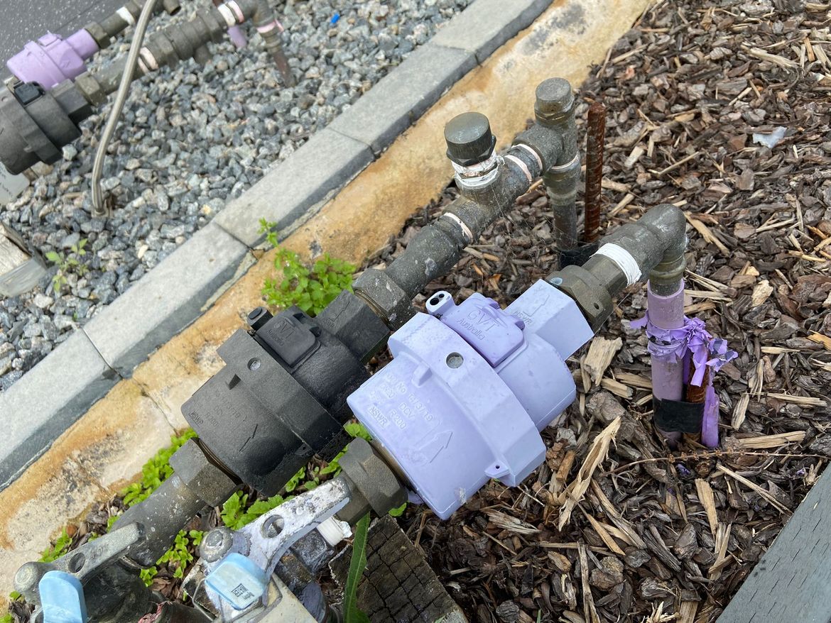

I could not find any hand valves on Mains Water. Am I looking at different location..?

I see from your photos that the water valves appear to be fully on. They are the levers just to the left (in the photo) of the meters.
I also notice that your hot water system is an "instantaneous"  (aka Continous Flow)  Rinnai B26.
The specs on that are that they can deliver (at 50° C) a maximum of 13L/min.
(And will need a minimum pressure of 200 kPa to do that, but pressure may not be your problem. It will take testing by a plumber to determine that.)
So, if you run 2 showers each drawing 5L/min, then you only have spare capacity of 3L/min for a tap.  If the tap user also wants 5L/min then the HW system will not be able to deliver and all outlets will drop in order to maintain the maximum of 13L/min throughput.
That is assuming that everything is working perfectly and the minimum pressure is available.
But the fact that you can run 2 showers and only run into problems when a tap is also turned on, suggests that the HWS delivery limitations may be a contributing factor to the  problem.
