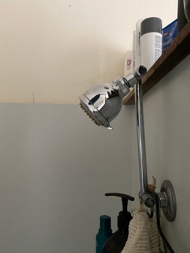

"(Would have to be at least 450mm height from the outlet)."
So, no commercially available shower head extension would produce the height you're after?
Possibly a dumb solution - could we connect two of these? Probably too ungainly...🤔
