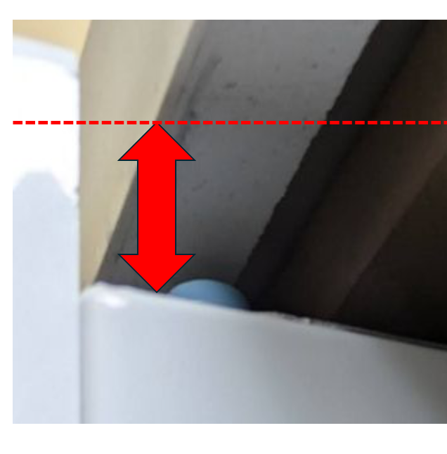

I recently bought and moved into a house, where the previous owner has renovated certain portions of the property.
One of the issues that I currently have is that my washing machine (+dryer) (height: 850mm) does not fit under the countertop in the laundry area.
I just need an additional clearance of 5mm. I had considered 3 options:
1. remove the top cover of the washing machine to slide it under the countertop 95% of the way.
2. remove the legs of the washing machine to achieve clearance
3. remove tiles from the floor or cut through the countertop?

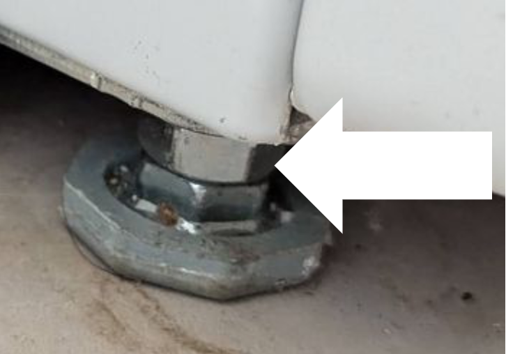

Option 2 did not seem feasible because I need the legs to stabilise the load when the machine is running - see picture
I am currently employing option 1 - (I do not like this, as the internal wiring are exposed)
I am not sure how to go about employing Option 3.
Would you have any other options that I could use? Something that does not cost a lot of money?

Are you using the feet to level the machine? If the surface is quite flat then there might be no need for the adjustable feet, as they are only need for un-even surfaces. Be aware that if you do remove them entirely, you should protect your tiles from any metal component on the underside of the machine. Perhaps a sheet of MDF would be sufficient.

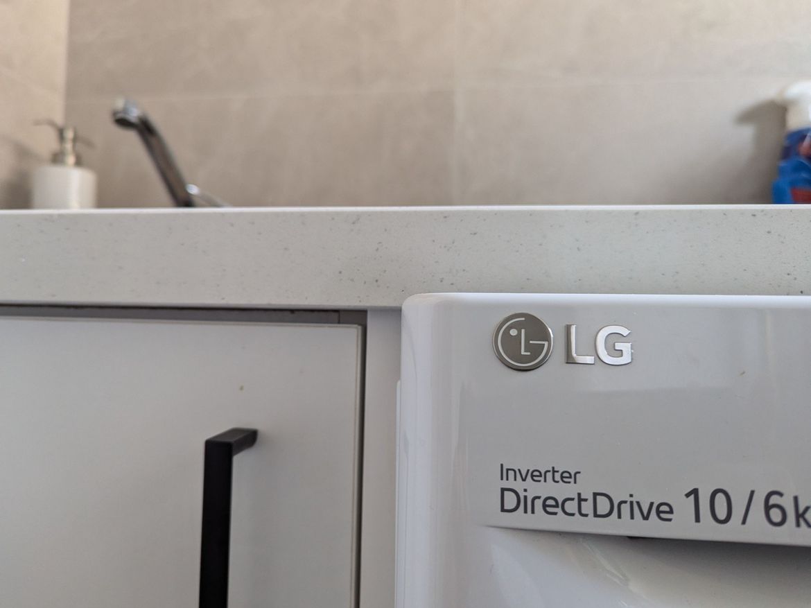

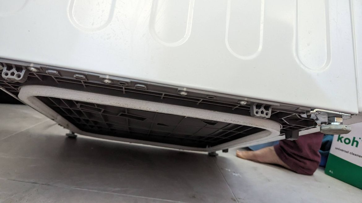

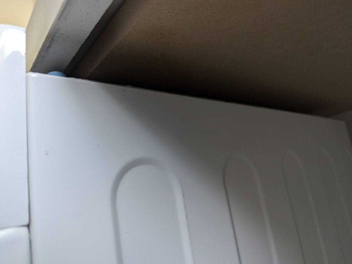

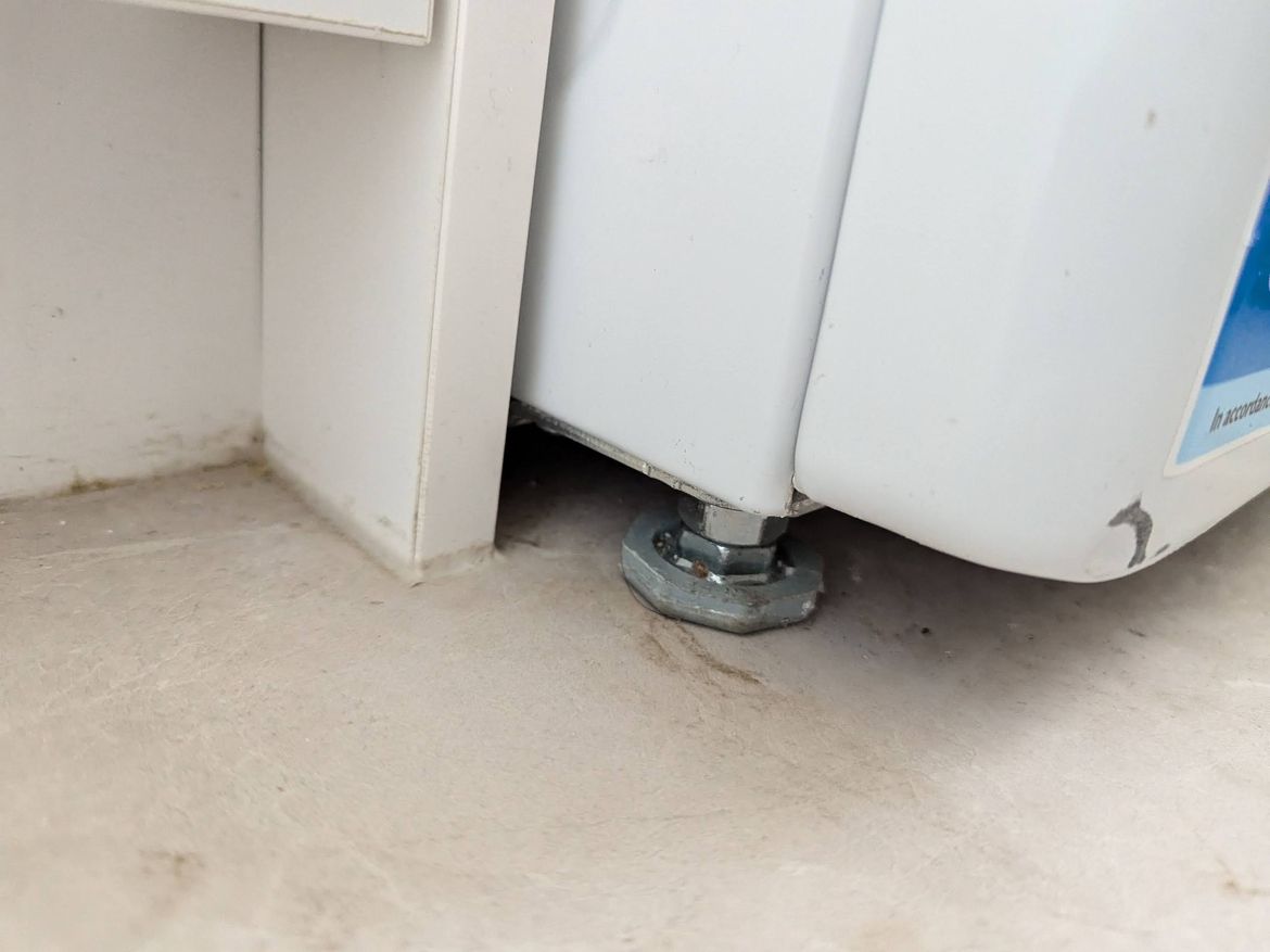

Hi @MitchellMc , Thank you for your response.
From what I understand, the most convenient option seems to be removing the feet and placing the washing machine on an MDF sheet.
I am attaching a few more pictures. Would there be any other suggestions that I could employ without altering anything on the washing machine?

Removing the feet will mean you lose any way to level the machine, which will cause major vibrations if unbalanced being a front loader. It also means resting the machine on sections underneath that are not designed to take the weight during operation, hence any issues caused will void any warranty. But you could try just removing the lock nuts which will allow the feet to screw lower, just as long as there is some clearance from any other part of the underside of the machine. Using Loctite on the thread will prevent it from winding once levelled.

1/ Remove the tiles and underlay back to the slab/timber floor as @MitchellMc described. This will give you a min 12mm clearance. A straight cut using a thin continuous rim diamond wheel on an angle grinder along a straight edge, then lift the tiles and underlay from within the cavity. The machine and floor integrity will be fine as long as the floor is clear of all debris.

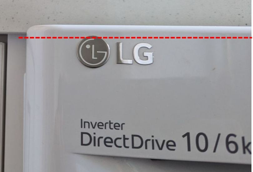

2/ Providing you have been able to confirm there are no electrical or structural issues, you maybe able to trim the top of the front facia (as per images) as it appears to be cosmetic at the top and you have some clearance available from that front facia to the actual top of the machine behind?
Screenshot 2024-06-18 at 10.16.46 PM.pngScreenshot 2024-06-18 at 10.20.29 PM.png

I am with @Nailbag on this one.... try removing those locknuts first up.
if that doesn't work, consider just removing the tiles that are in line with the feet, so that the machine has two tile-free grooves to slide in and tiles could be reinstalled (i.e. replaced) later if required.   (Given that machines are usually standard height, chances are any new machine will have the same issue, so I can't imagine needing to put any tiles back though. Judging from the hole size error, it looks like the d-i-y cabinet maker may have forgotten to allow for the fact that tiles would going under that area when designing the cabinets.)

The removal of the lock nuts was where I went first, pretty much what everyone is suggesting. Looking at your Benchtop is it an engineered stone or a solid surface type one? I was just looking at underneath the bench and can see some MDF. Could that be modified (Routed or cut out) to allow you to get the washing machine with lid underneath? You may need to strengthen the underside with steel as it looks like its supporting the actual bench. You would also nee to route the edge of the bench at least a little.

Hi @roshanrn I agree with all the great ideas, if possible I would raise the countertop and insert a filler spacer in between the the countertop and top of the cupboards that matches the cupboard doors

1. @Dave-1 - I see that cutting to reduce the thickness of the MDF would not help as the stone has a lip underneath which would prevent the top cover from being put back on (unless I cut through the stone as well (not confident enough to do that)). Also, I did consider not putting the washing machine in its current location - but it creates other space issues in a fairly small laundry footprint. The end of the cabinetry is the wall.

Assessing all the ideas put forth; I see that removing the lock nuts from the feet may give me the clearance I need to put the top cover back on. Will try that first. If it doesn't work, I'll look to work on the floor tiles.
