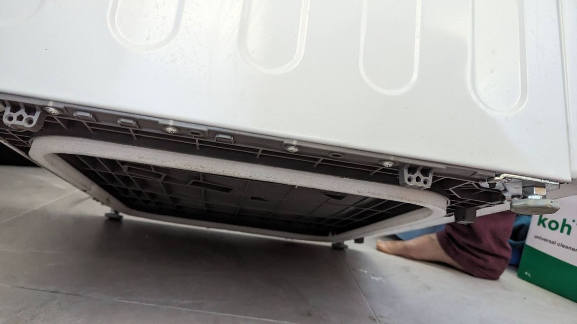

Option 2 did not seem feasible because I need the legs to stabilise the load when the machine is running - see picture
