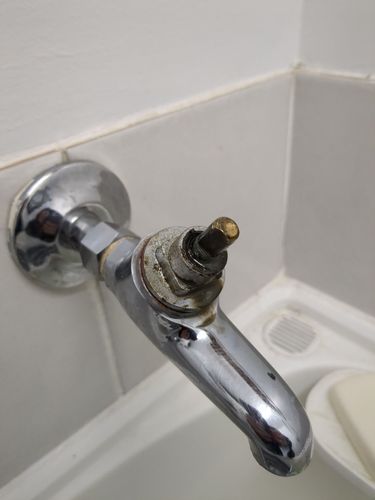

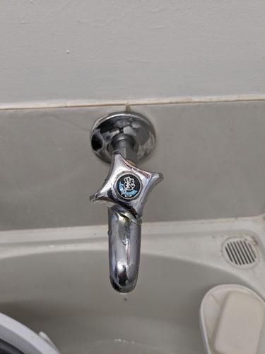

Need help to know how to get this old style tap apart to fix a leak. Which tool do I need to undo it?

Your first image appears to show the top of the brass spindle. Was the button cap screwed on? If it was, and you've now exposed the spindle, you'll need to pull the tap handle straight off the spindle. It's likely a bit stuck and might tap a few light taps with a hammer from behind to convince it to let go.

This is not like other taps I have fixed! Which part unscrews?

The square section - try a shifter or open ended spanner on it. Anticlockwise.

You are so close to being able to remove the spindle and repair the leak. I suggest going with @Noyade's suggestion and using a Shifter. I've placed an image below with a yellow mark on where the shifter is supposed to sit in. Turn the shifter anti-clockwise to loosen the spindle.

We have tried these suggestions and the square part does not move at all. The whole tap starts to rotate. If you hold the nut close to the wall with another spanner, there is no movement at all on the square part.

I agree with @Noyade, if the tap is too difficult to disassemble it might be time to replace the entire tap. Another option is to remove the tap and place it in a table vice so that you can apply force when removing the spindle.
I suggest having look at Shaw & Mason Chrome Plated 45° Female Bib Pillar Tap WELS 3 Star 9L/min. This is very similar to your laundry tap, but just to be sure, I recommend bringing your old tap to the store so that you can compare its size and length.
