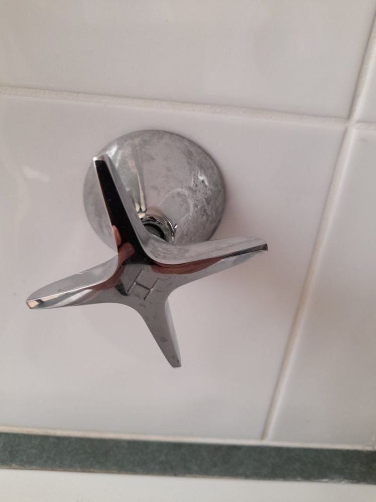

A few months back a plumber fixed a leaking pipe and I asked him to stop the laundry tap from dripping. His young apprentice did this - but its now leaking more.     I would like to take off the handle and see if it needs some more plumbers tape - but I'm not sure how to take off the handle - it doesn't seem to pull off - what to do?

Hi @ennoh,
If you look at the underside of the tap handle where the spindle connects to it, you'll likely find a little brass threaded anti-vandal fitting. It requires a special spanner to remove, and the spanner included in this Kinetic Spout And Handle Repair Kit will likely fit it.
You might not need to remove the tap head to access and remove the spindle from the wall. Once you've turned your mains water off and run the tap until no more water exits the spout/showerhead, turn the tap head anti-clockwise until it is in the fully on position. Unscrew the conical tap flange from the wall. You should find there is now enough room to slide the flange up to the tap head and get under it with an adjustable wrench. Once you undo the spindle from the wall, the whole assembly will come out as one piece. If it's the spout or showerhead that is dripping water, the tap valve will need to be replaced. If the water is leaking out around the tap flange, then that would be the thread tape or spindle O-ring. You'll get a replacement spindle O-ring in the Kinetic repair kit.

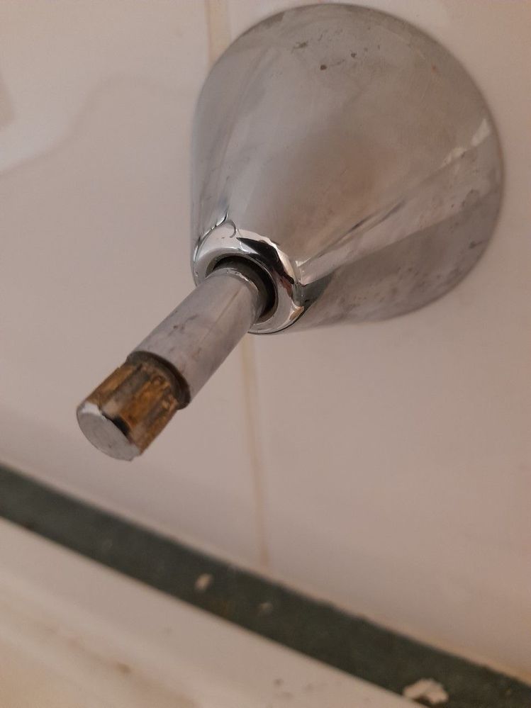

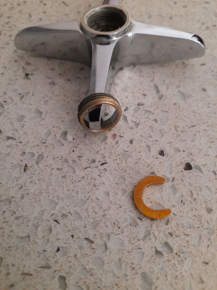

Thanks Eric,   I am doing this myself because the plumber who supposedly fixed the leaky tap a few months ago did a bad job.   On taking it apart I can see that he didn't insert a washer.   Anyway - I have successfully fixed the leak and all I need to do is put the handle back in place, but I am having a problem putting the handle back on.    There is a little ring that is to be screwed into the handle.  Should it be screwed in as far as it will go or just so the exterior end is flush with hole in the handletap handle 17.2.23.jpg?    And please explain how I insert the horse shoe piece.  I have tried to install it but the handle isn't screwed on in the normal way and its hard to see what keeps the handle in place.

Hi @ennoh
You are so close to the finish line; the sequence goes like this. First, slide the brass threaded locking nut in with the notches facing the wall. Next you place the brass horseshoe on the slot of the spindle. The last step involves sliding the handle on and making sure it lines up with the cut grooves. You know you've done it correctly as the brass horseshoe goes into the handle. You can then start screwing the threaded locking nut by hand, this in effect will sandwich the horseshoe between the handle and the threaded locking nut. The last step is to use the tool to tighten it properly.

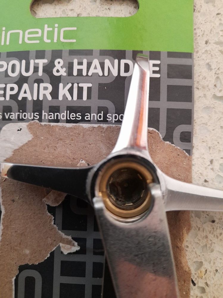

Re: leaking laundry tap
yes - I am almost there - but I couldn'thandle repair gadgethandle repair gadget understand why that little tool in the last step wasn't gripping on to the other part, but on further study I realised that it wont work because its just a tiny bit too wide and will not fit into the two slots.  Any other suggestions?   So close but so far....
