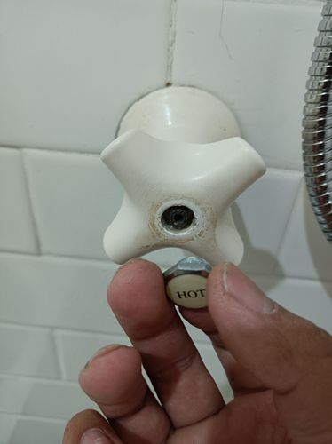

I want change to 1/4 turn assembly, but the old one is so hard to take off. I couldn't find any nut inside but just can't take off.πππππππ
Hi @glenwu,
From the vintage of your handles and spout, I'd say they are pre-grubscrew usage and push-on spouts. I suspect your spout will be a screw-on version. Have you tried to unscrew it by hand or used a tool? You'll typically need to use a tool as it will be likely quite stuck. Don't force it too hard, or you could damage the plumbing work behind.

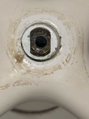

From memoryΒ there is a thin nut that sits on the end of what you can see there but it seems to be already taken off.
From there it should just shimmy off with some effort of rocking it side to side whilst applying pulling action.

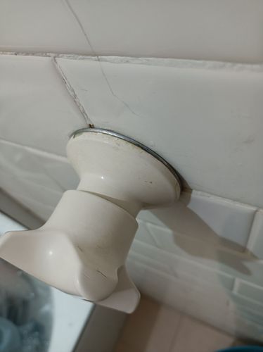

Before I make any recommendations, can you please post a photo of the screw set you removed from the top of the handle and would it be possible for you to post a photo of the wall tap from the side? This will allow our members to assess the tap head assembly. We can then make recommendations on how to remove it without damaging the tap spindle.

That type of top is notorious for seizing and being difficult due to the spindle shape not allowing you to turn the knob in order to break away any debris. Have you tried spraying into the tap knob with CRC or WD40? You'd need to leave it to soak in a few hours then try wriggling it off again.

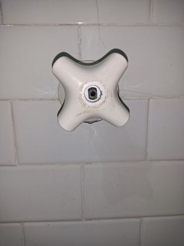

βjust a simple one from top
βI got experence change a few by myself but totally no idea how to do with this. maybe use a grinder totally break itπ€

Thank you for posting those photos of your wall tap assembly. I'm sorry to hear that the handle is still stuck, sometimes these types of handles get stuck due to calcium build-up inside the handle. I suggest spraying it with CLR Ready to Use 750ml Calcium Lime Rust Remover and letting it sit overnight. I then recommend getting a hammer with a wooden handle. Wrap the wall tap handle in a rag and firmly tap the handle all around with the wooden handle. Do not use the metal head of the hammer.Β
Then proceed to wiggle it again, tap the handle again with the wooden handle and wiggle again. Repeat this process several times and if no progress is made, I suggest it's time to engage the services of a registered tradesperson. Forcing the issue might lead to further damage to your tap assembly and your plumbing fittings.Β
