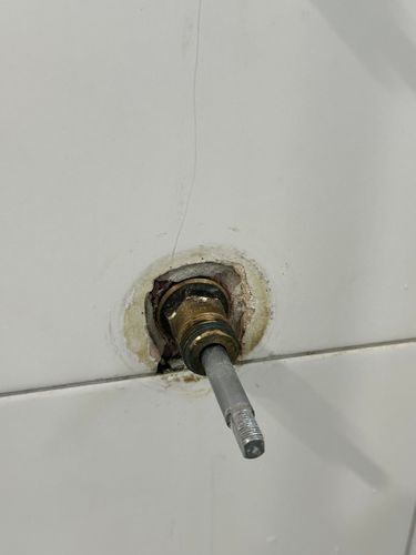

Trying to remove the taps in my shower to fix a leak. Cannot get these rings undone. I think they are 22mm. Do I need a deep socket or 22mm ring spanner?
also, what should I buy to fix the leak?

Do you have a set of long tube sockets? They're inexpensive and available as a kit @ Bunnings.
Welcome to the Bunnings Workshop community @Bprice88. It's brilliant to have you join us, and many thanks for your question about removing a spindle from the wall.
Typically you'd use a tap spanner to remove spindles. I normally just grab this multi-fit pack, which includes all the different sizes. If the included T-handle doesn't give you enough purchase to undo the spindle, you can add an adjustable spanner to the end to create more torque. Be a bit careful, though, as you don't want to risk damaging the plumbing.
If this leak is dripping from the shower head, you'd replace the valve washer.
