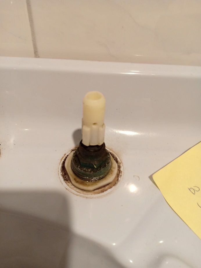

Hi, water slowly dripping despite tightening the holder, guess must be the washer. how do I change the washer from the attached tap? This is the 1990s tap. In the 2nd photo, underneath the sink. No leakage under the sink though.

Hi Eric,
I hv unscrewed the tap handle and it looks similar to this. Do I still need the kinetic kit to remove and replace washer?

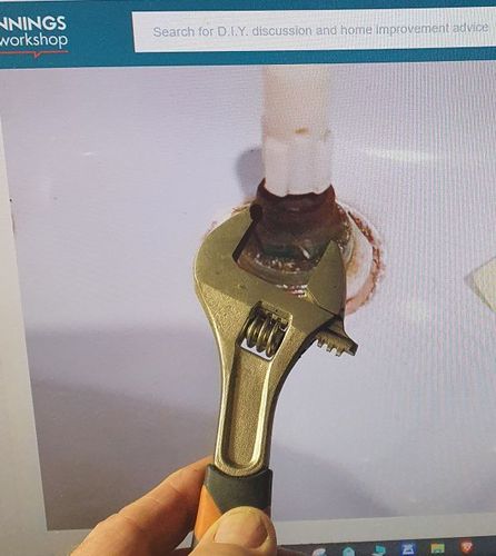

Hi Gavin.
You've moved onto a different sink and taps?
Get a shifter onto it and rotate right...
Water turned off?
Washer ready?
Good luck! 🙂
It's great that you've received fantastic advice from @Noyade. The picture that's been posted is the perfect way to remove the spindle off the base of the tap assembly. Because you've removed everything, you will not need the special tool anymore.
