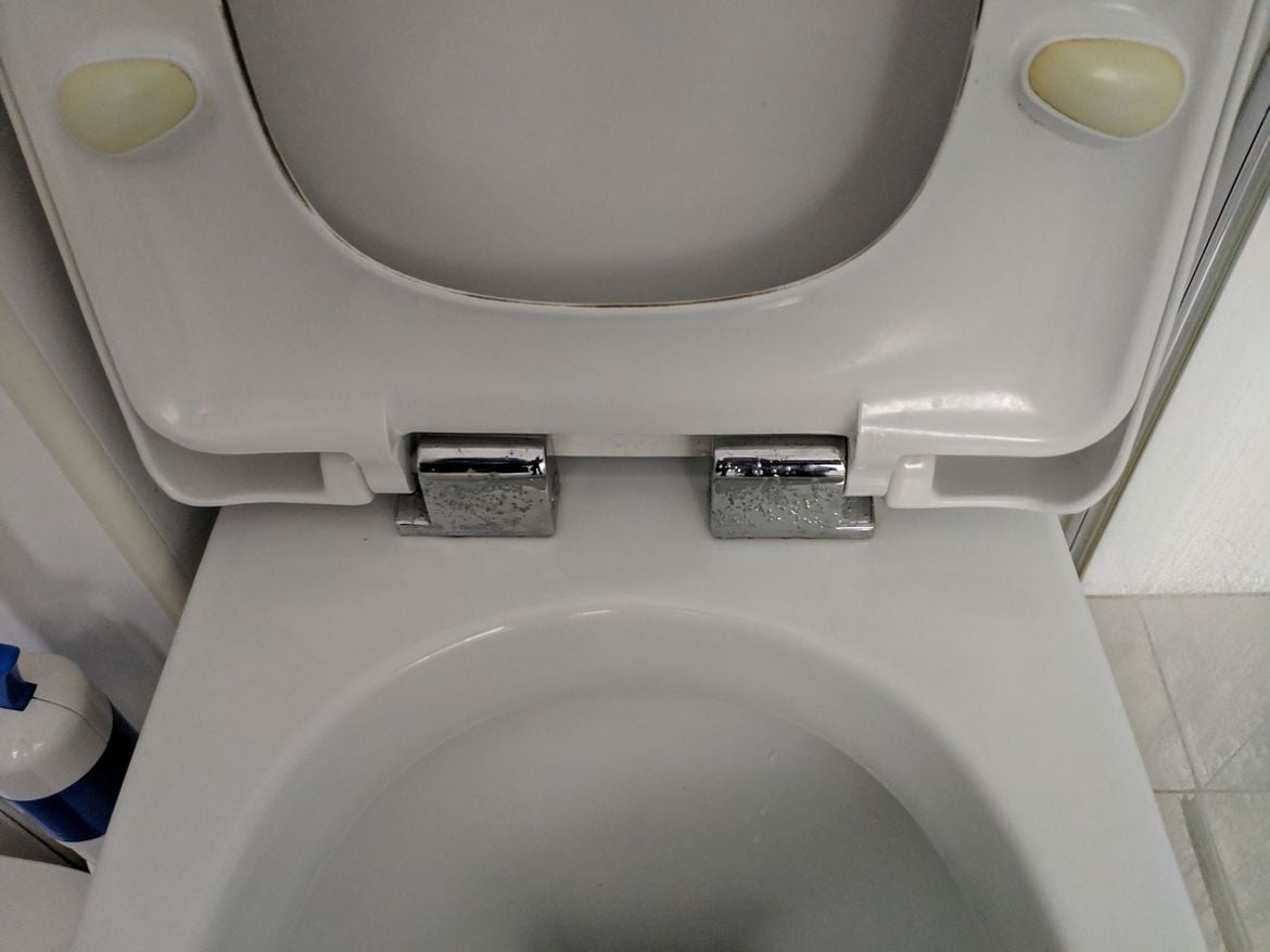

Hello folks,
Trying to replace an existing toilet seat and cover as the screw fittings are pitted and corroding.

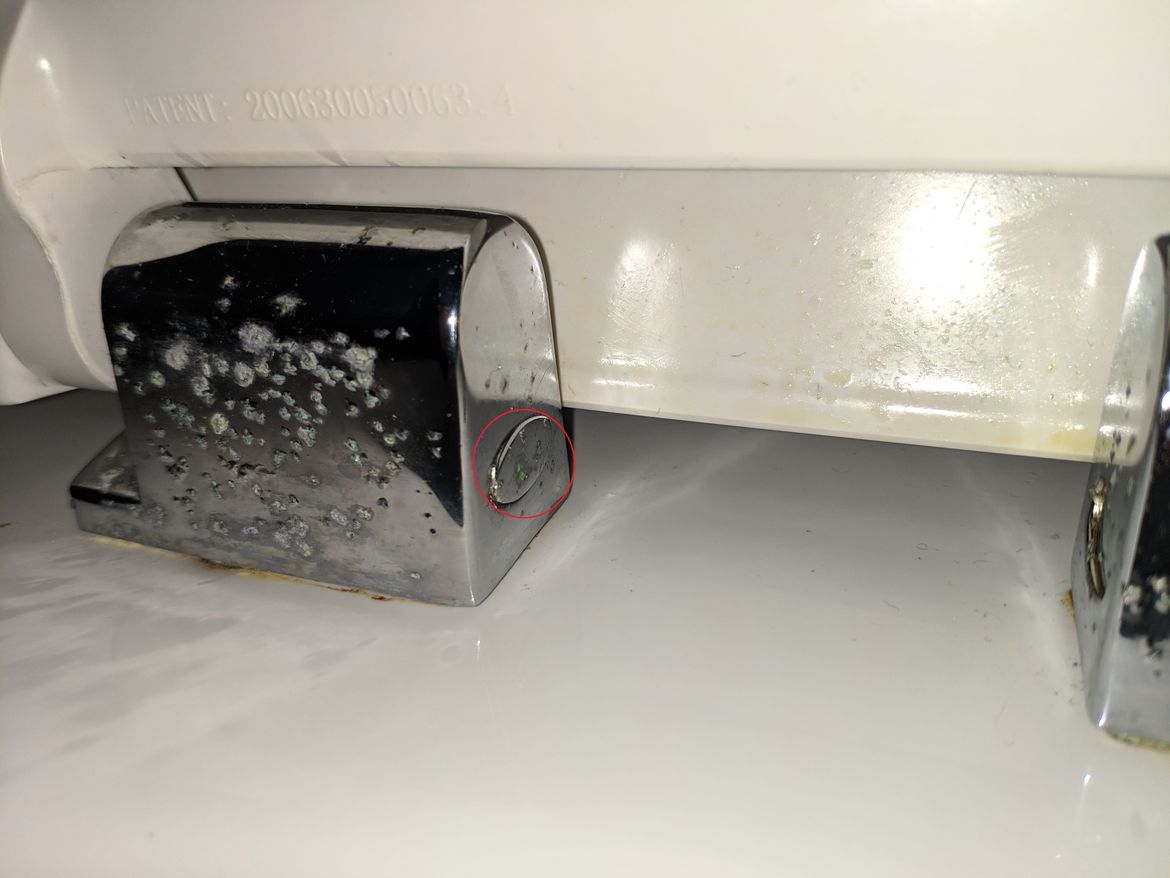

I am not sure how to remove the screw fittings though, the only thing I can see are 2 small caps (left side circled red in 1st pic) which are difficult to dislodge.
Should I drill them out and can then reach the insides ?
Thank you.

Most have a nut on the underside that you can undo to remove the seat, for a streamlined bowl that area is sealed off. I have a feeling that those caps are a release button so the seat and hinge can be lifted off, the other blind hole alternative is if the seat has a split hinge so it can be pulled off and the hinges unscrewed that way, I would try to feel if there is a gap in the seat hinge if the push in and lift fails to show movement.
Given that some junk may of collected in the area gloves are a good idea.

Those caps are hard and I can't seem to move them even with WD40 sprayed.
It's a sealed bowl so no nuts on underside.
I will continue to try and see if I can remove the split hinge somehow but thanks for pointing out the caps may be release buttons.

I'm sorry to hear you are still having difficulty removing your toilet seat. My first thought is similar to @Brad's suggestion that those are release buttons or cover caps. Since you've had no luck removing them or pushing them in, I'd like to suggest you look elsewhere. Check on the other side of the fitting where the hinge pin comes out of it and also on the back of the hinge behind the toilet seat. You'll be looking for a tiny little grub screw, it will only be a few millimetres across and most likely concealed in a hard to reach place. I've included a few images below of what you might be looking for and the positions they could be in.
If you do find them, undo them with an allen key. Once they are undone generally the hinge slides off a base plate, so try pulling the whole seat and hinge assembly towards yourself or pushing it away.
If you can't find any grub screws on the hinge, that would be a good indication that they are under the caps or the pushbuttons are jammed. If the caps do not push in, try a small flathead screwdriver and prise them outwards.

There are no screws anywhere that I could find, and the caps look to be jammed hard
As I couldn't make any progress and frustration had set in, I enlisted the help of a plumber who had to hacksaw the screw off from the base.
It made some marks that the new steel covers could hide so problem solved.
Unfortunately the cost for getting the plumber out was more than the new seat cover itself but I wouldn't have been able to sort it out myself.
