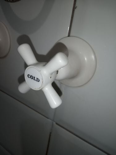

I am looking to replace the taps in my bathroom which look like this:
There is no cap on the tap to get a spanner around, no screws anywhere on the outside to unscrew and no visible way to remove them that is obvious other than turning of the main water and turning the head until it falls off. Any ideas? A friend helped with the basin taps and we just have up and sawed the tops off (And had to drill into the skirt bit to move that too!).
There are 4 taps to remove- is there a way or am I whipping out the hack saw?
Hi @seannami,
The best place to start would be by removing the cold sticker and seeing if there is anything underneath. This is the traditional location for a nut that retains the handle onto the spindle shaft. Failing that, I suspect a small grub screw in the side of the handle that pins in onto the shaft.
You might find that the handles are a press-fit and don't come off. These taps are removed by unscrewing the skirt fully, which allows access to the nut underneath. This nut unscrews the whole spindle and tap assembly out in one piece. However, this style is usually only used on basins, and I'd imagine the spindle on these wall taps is recessed too far into the wall for that style to be used.
You'll likely need to use some multi-grip pliers for the skirt. They'll give you a good grip on the skirt but ultimately destroy the finish in the process. However, that won't be an issue if they are just going in the bin anyway.
Let me know if there is nothing under the sticker and you can't find a grub screw in the side of the handle. If it's a grub screw, there will only be a tiny little hole.
Thanks @MitchellMc
I managed to get the sticker off and there is a cap over where I assume the screw is. This is as far as my friend and I got before the hacksaw had to come out. Any idea how to get the cap out?
Damage is where I tried to shim and/or turn it with a screwdriver.
We tried a shifter, strap wrench and pliers and nothing gets those skirts off. Whoever put them on REALLY didn't want them gone!
Is this a seam @seannami? If so, can you rest a flat head screwdriver right on top of the edge of the cap and, with a downward driving strike from a hammer, dislodge it?
Failing that working and in the absence of a grub screw, I'd suggest cutting them off with a hacksaw would be the next best solution.
Thanks! It's going to have to be a hacksaw, nothing is budging.
Any chance of an autopsy - once removed?
I would love to know how they were suppose to come off.
