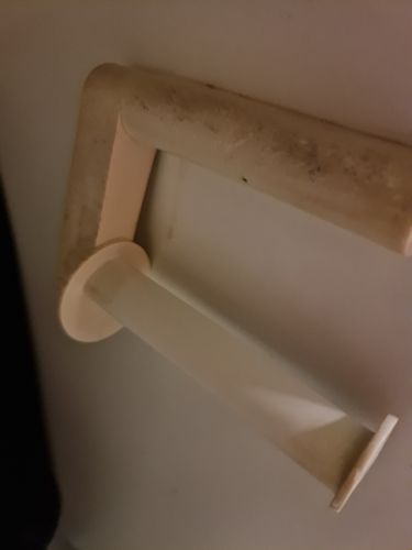

Unable to work out how to remove this yucky 🤮 25 yrs plus stained grotty loo paper holder from the side of the vanity?
I replaced a towel rack earlier this year that was same/of set with no trouble but can't see any release points on this paper holder

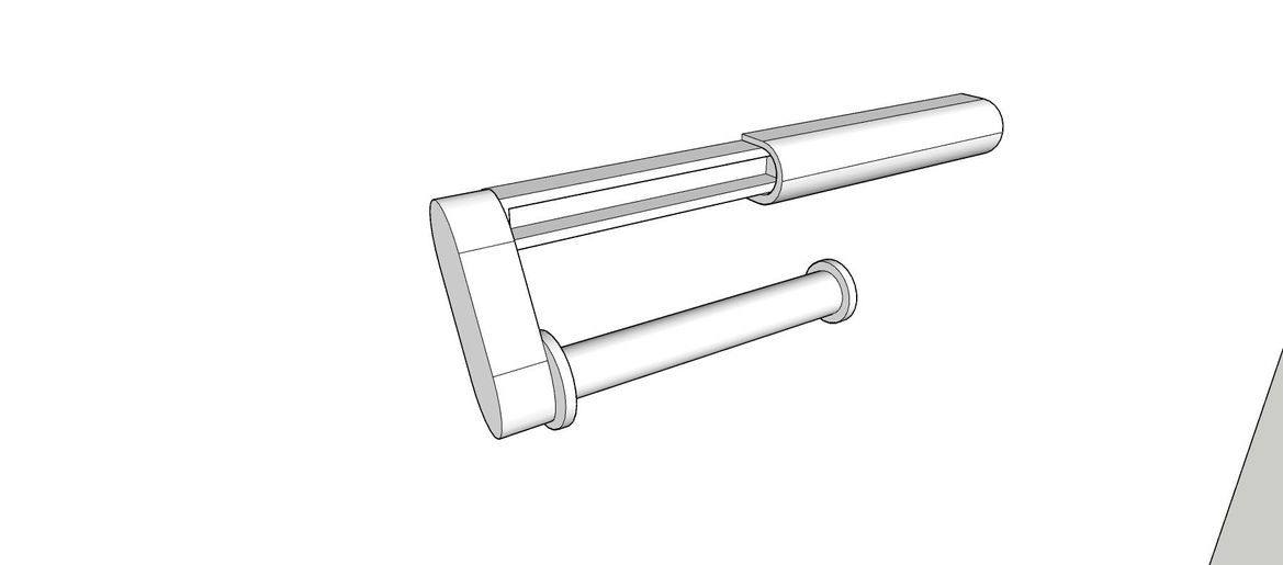

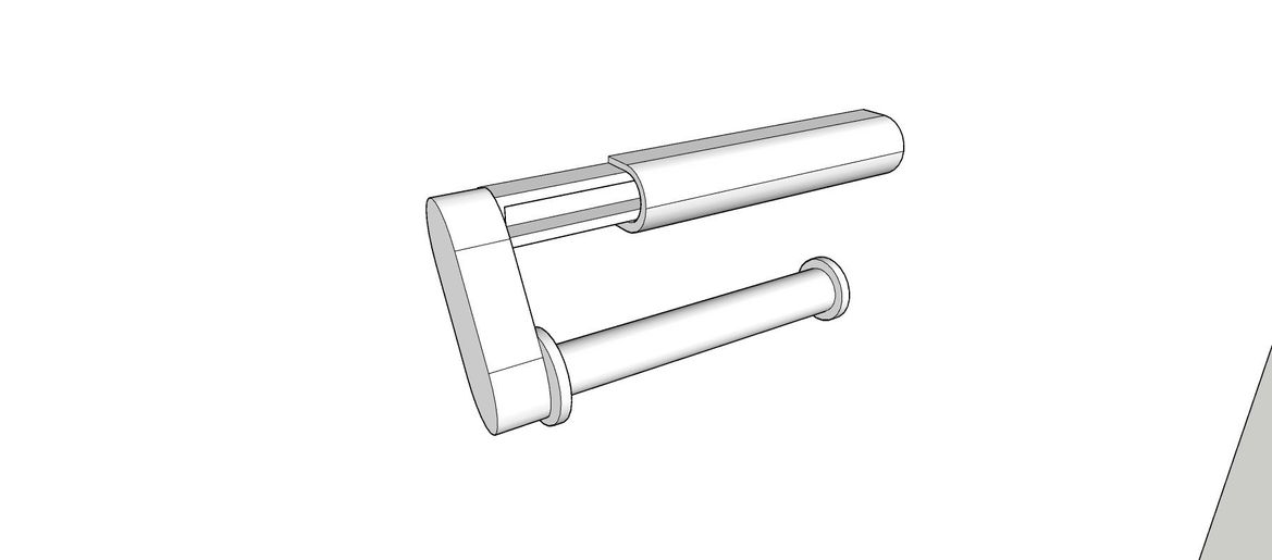

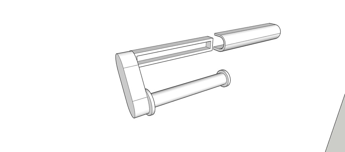

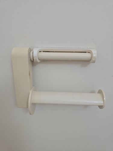

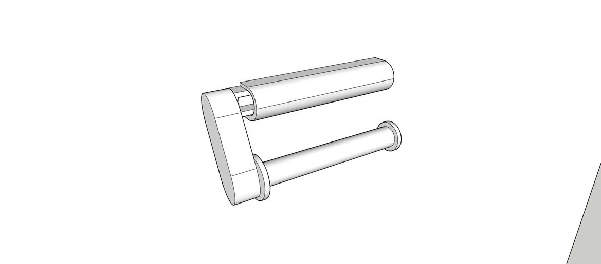

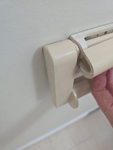

It's great that you've received excellent suggestions from @Noyade. I've placed a visual guide below to give you an idea on how to remove the toilet roll holder cover. It sometimes happens that the cover gets stuck due to its age, it might be necessary to use force on the cover to remove it.

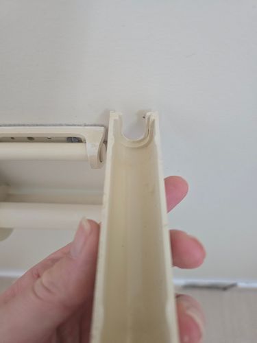

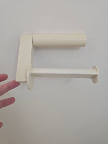

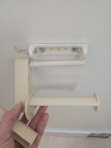

These pics might help any future folks remove this tricky holder.

Did your cover pull straight off rather than sliding off?
