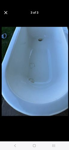

How do I repair a 10 cent sized chip in the bottom of an enamelled white bath?

Were you able to share some photos of your bath? It might help members to see what you are working with.

My apologies for the late reply. It's great that you've received excellent advice from @Jason. The procedures and products I mentioned in that discussion are the PC-11 56g White Epoxy Paste to fill in the damage on your tub. Once the damage is filled, you will need to wait for it to cure, and then you can sand it down. The other product is the White Knight 500ml White Tub And Basin Paint and is more suitable to fix enamel steel baths. Would it be possible for you to post a photo of the damage to your tub? This will give us a better idea of its condition and allow us to give you a more comprehensive recommendation.
