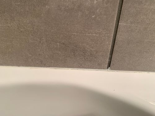

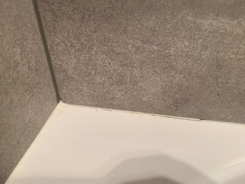

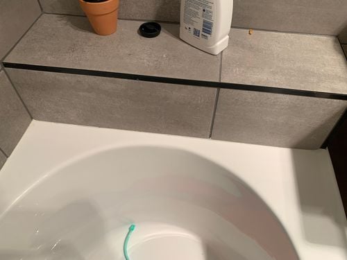

Hello,
I have recently noticed in my bathroom that the grout between the tiles and the bath tub has developed gaps. Not sure of
the reason as the construction is fairly new.
However, I am unsure of the long term complications. I am unsure if it will have detrimental effect to the gyprock if the water penetrates through the gaps especially considering it’s location I.e bath tub which often gets used to shower my son.
I want to repair it and want to know how I should go about doing it? I will appreciate any comments, thoughts and guidance.
Much appreciated.
Saad
Re: How to repair tile grout in bathtub?
Welcome to the Bunnings Workshop community @SaadMalik. It's sensational to have you join us, and many thanks for your question about repairing grout.
I wouldn't be too concerned about the crack, it's just the newish build settling, and there is a waterproofing layer underneath to prevent moisture from getting to the Gyprock. Although the current crack is not cause for concern, I recommend repairing it.
The joint between a bath and tiles is somewhere movement can be expected. Typically on a joint where movement occurs, you'd use a flexible silicone instead of a cement-based grout. I'd recommend removing the grout with a grout saw, being careful not to scratch the bathtub and replacing it with a silicone sealant. It seems like a very thin joint of grout, so it might be easy to cut it out with a retractable knife instead of the grout saw. Remember your PPE, including gloves and safety glasses. Also, make sure to cut away from your hands.
Check out this recent project by the fabulous @mich1972, where she repairs her grout: How to make tile edges look neater. Also, we have a helpful step-by-step guide: How to apply silicone sealant.
