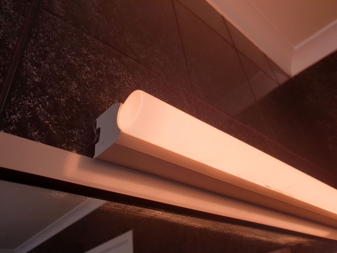

I would like to know how to replace the lamp like attached photo. I cannot see any screw around the light. Except 2 holes both ends of the light.
Hello @quynhpham55
Thank you for sharing your question about how to replace your Linestra light bulb. The bulb is attached with a mounting foot on each side of the bulb. To remove the bulb place your hand on each end and gently pull the bulb out towards you. It is held in place by two steel clamps that hold on to the foot of the bulb. I've placed a picture below to give you a better idea of how it's mounted.

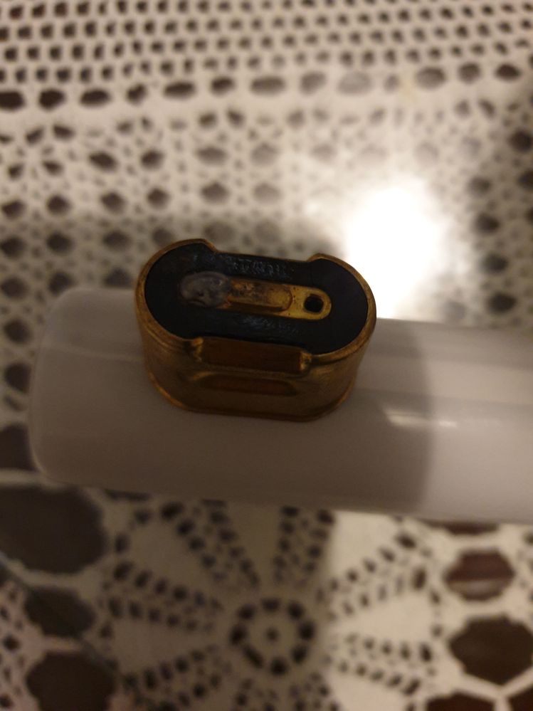

Thanks again for your help. I have another query with type of bulb I should get for replacement. I have pulled out the bulb as you said and below is the ends of the bulb. Is it can be a LED or normal fluorescent bulb ( I can see the length is 500 mm).
This is the link I can find on the web about that bulb https://www.gmtlighting.com.au/shop/product/t305008s14s-architectural-8w-3000k-s14s-500mm-non-dimmable-3172 but the ends are not copper as mine.

The closest equivalent I can find is the Mirabella Architectural Incandescent S14s 240V 60W 500mm. This product will have to be specially ordered at the special orders desk at the store. But before you proceed to order this product, I suggest looking closely at the surface of the bulb, you should find the printed model number on it. You'll have to find exactly the same type of bulb in order for it to work in your fitting.
Would you be able to post a picture of the text printed on the bulb? I'll then be able to track down a bulb for you. Our providers Osram and Mirabella carry this type of bulb, but I'll need the information printed on that bulb before I can make any inquiries. I'll also be able to find out if an LED will work on your fitting or if you'll only be able to use fluorescent types.

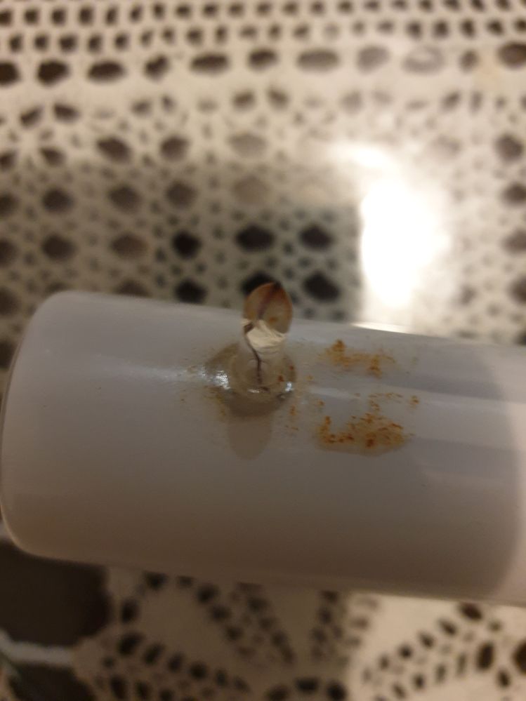

Hi @quynhpham55,
I noticed you've had one of the terminals/feet break off the globe. Is this foot stuck within the wall fitting, or did it break off after removing the globe? If it's stuck within the fitting, I'd strongly advise you not to attempt removal yourself and instead employ the services of a qualified electrician and do so. You might also like to inquire whether swapping this light fixture out for a more updated variety compatible with LED would be an option.

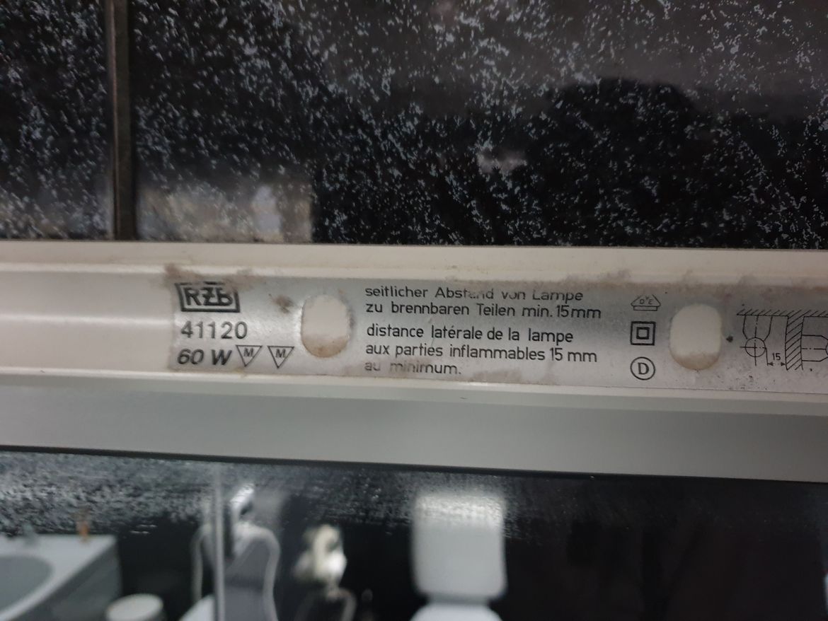

The image below is what I can see on the base:

Given that this is a filament (incandescent) type lamp/fitting, I don't like the chances of you being able to get replacement lamps, going forward.
Also, regarding this being installed in a bathroom, I would recommend something LED with an IP rating, there are fittings like this that are designed for this very situation and it will more than likely be a lot brighter than the existing lamp.
It would also be a lot safer if the circuit that supplies this fitting has an RCD on it, because of it being able to be reached while standing on the floor.
