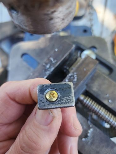

OK.
I made another cut just now. This time 5 mm thick steel - so I can make a good countersink.
If I drill (5mm dia?) 10 mm from the edge - dead centre - this leaves a 5 mm 'lip' on the other side to catch the door?
Is this correct?
Below is 25 mm X 16 mm X 5mm...

Hello @Noyade
Thank you so much for another "live testing" scenario. It's always amazing to see you build these solutions in real time. Let me tag @RenoFun to make them aware of your example.

Thanks @EricL
If you think it will work @RenoFun  - it's yours. Just PM me your address so I can post it off.
Cheers!

G'day @RenoFun
Yeah, that'll fit (but don't use that screw again). I drilled a 5 mm hole with a large 10 mm countersink.
I won't paint it.  😉
If it doesn't fit or suit. We can move onto Prototype No.3.
PM me your address - and I'll post it off.
