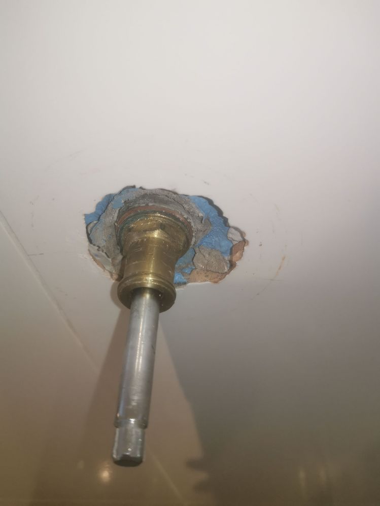

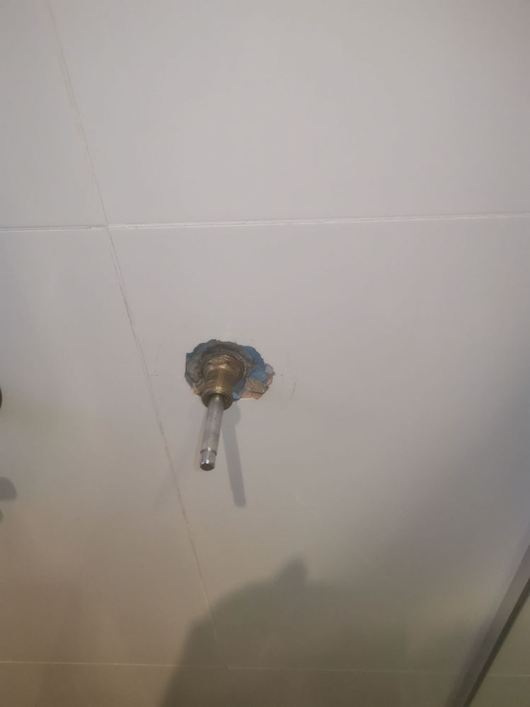

I plan to change bathroom shower taps due to leakage from shower head. I can succefully remove the tap from spindle.
However, when I try to use tap spanner to remove the spindle from socket, it won't budge at all!!!
Any advice would be appericated

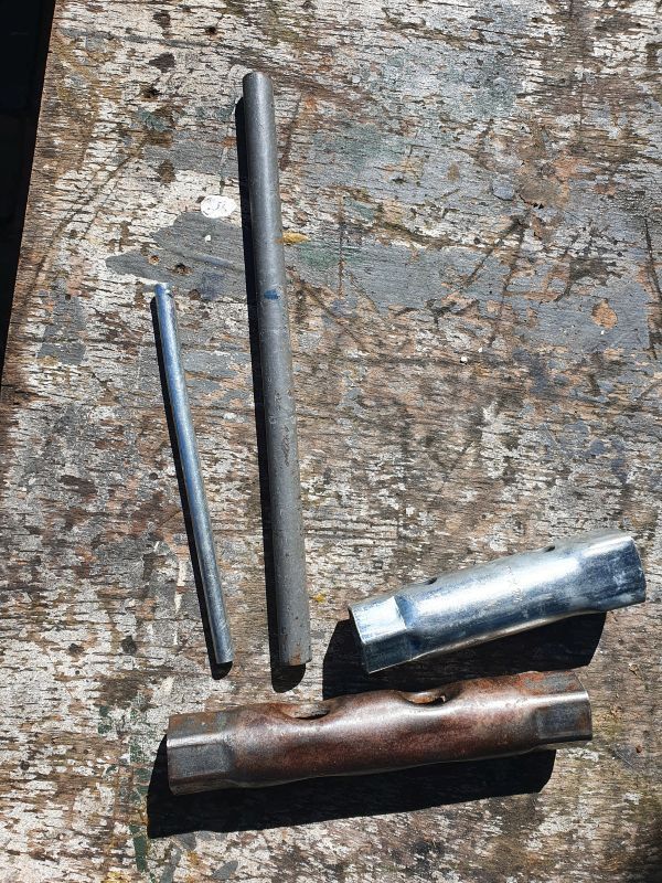

Clearly we don't want to apply too much torque to cause damage to the pipework - but at the same time the 'bars' provided with many tap socket kits are far too small in diameter and length.
I suggest soaking with WD 40 and upgrading the bar to say a 10mm steel rod and 250mm long which I'm sure would be available at Bunnings in the steel section.

It's great that you've received excellent advice from @Noyade. Just to add to the suggestions already made, I recommend using a Brasshards 15 x 450mm Galvanised Pipe as a lever over the steel rod to give you more torque when turning the tool. Please note to keep an eye on the spindle housing and make sure that it does not twist when applying force to the tool.

Tried WD40 and bigger rod during weekend, unfortunately it has little use, spindle still stuck as hell.
Any other advice? Is there any steps I missed to remove the spindle?
