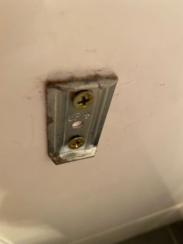

I have this annoying toilet roll
holder, which not matter how many times I tighten the screw, keeps falling off.
I’d like to secure it permanently but not make it impossible to get off one day if needed, so I’m thinking that gorilla glue etc is off the table.
I have seen in America some people use removable thread adhesive but can’t seem to find the same here.
Any suggestions welcome please - otherwise I fear I may throw this thing across the room one day.
thank you
ps. Apologies it looks so filthy - promise my bathroom is clean!
Hi @HD,
Looking at the wall bracket, you can see that the centre at the top appears to be slightly rolled down, whereas the bottom is fairly flat.
It might seem like a simple solution, but have you tried simply turning the toilet roll holder, so the grub screw is on the bottom of this bracket?
It looks like part of the problem might be that the grub screw is hitting a curved surface on the top of the bracket.
You could also apply some Thread Seal Tape to the grub screw before screwing it in. This will help create more friction between the grub screw and the thread in the toilet roll holder, but still allow it to be removed when required.
A combination of these two things should give you a better hold.
Allow me to tag some of our knowledgeable members to see if they have any other ideas, @Noyade, @Dave-1, @Jewelleryrescue.
Hi @HD
@JacobZ Is right i think the grub screw should be underneath the rail as sometimes the mount is designed for the grub screw to hit a flat surface.
The mount you show in photo is the right way up as the it SAYS 'UP' so thats almost confirming the grub screw needs to be mounted from underneath and my make a big difference to holding it in place. But even the best mounted rail will need a look at if it is being swung on. I slipped on tiles once and grabbed the rail to safe my butt. So life happens it was a little bent after that but fixable.
1 First try mounting rail with the grub screw pointing down this should help greatly ( do both ends make sure mount says up both ends. or examine them to match each other )
2 Use a drop of locktight on the thread as you need, Or some times a drop of clear nail polish on the outside of the screw will stop the screw self unscrewing (not on thread) Handy tip for many screw applications.
3 If the rail is constantly being swung on ie used as a hand rail or kids etc the bracket lugs may have being bent slightly out of shape. If you think the rail is loose pushing it on with out doing up grub screws, I would tap with a hammer the metal bracket flaps only to approx 0-5mm open starting with the bottom flap hammer tap gradually and test as you go for snugness so when mounting the towel rail it is naturally firm fit before grub screws do up (loosen grub screws before hammering to feel for natural firm fitting between the mount and bracket.) If you over open flaps simply tap them closed ever so slighly so every thing fits snug.
Hope this leads to a more stress free rail/ ![]()
Morning @HD
Going through @JacobZ 's explanation makes perfect sense. (The scews dont pull out of the wall do they?)
My first step would be to follow his suggestions and have that grub screw turn down to a flat surface instead of the rounded one. I probarly wouldnt use loctight on it at this point until you know its worked.

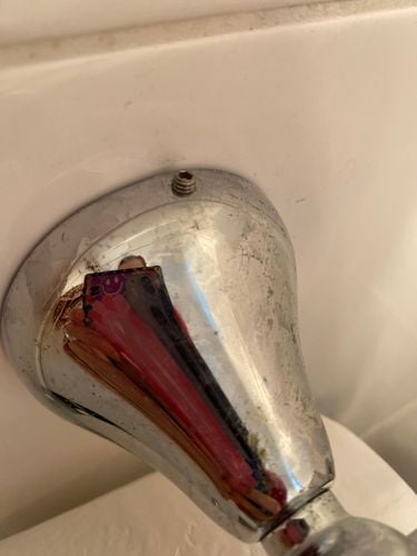

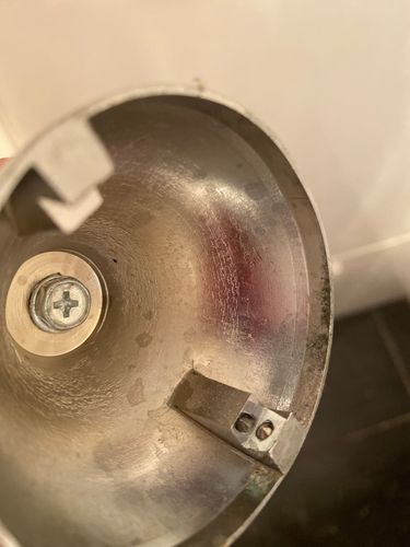

Morning @HD
How did you get on?
To my thinking - there are two angled notches in the shell that should receive two angled ends in the wall plate.
Like this...
The conical head grub screw should then turn, extend and spin forcing the bottom of the shell against the wall.
In other words, that bottom lip should not be straight.
If that makes any sense.
I would steer away from any Loctite with the grub screw.
Cheers!
