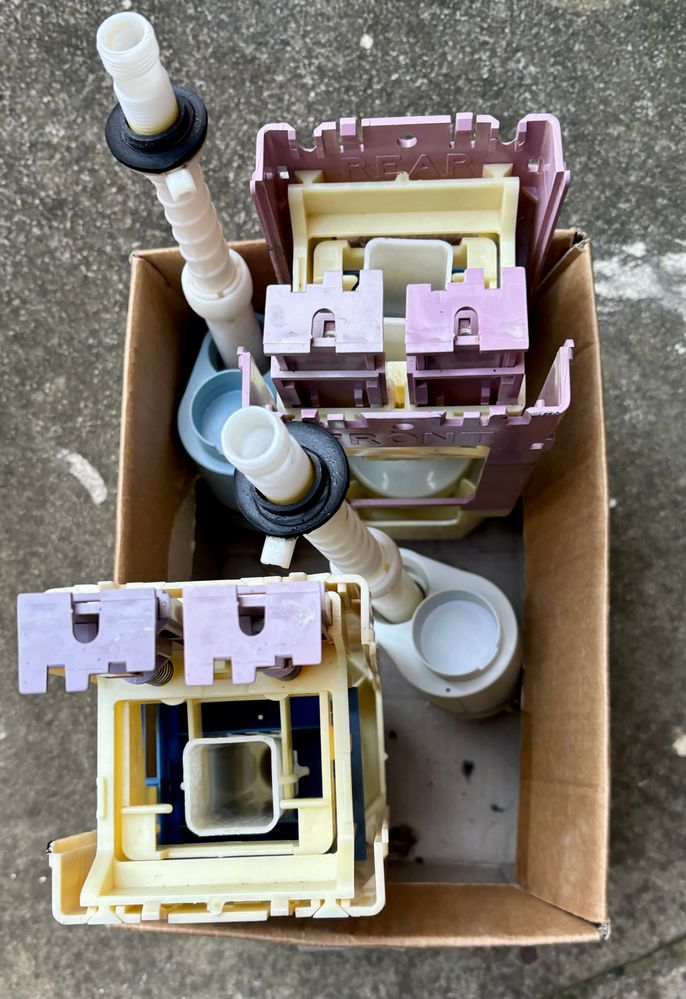

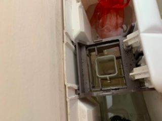

 I have this type of flush dual valve and what other dual flush valve can I use in caroma toilets? I can’t find this type in the store.Any other solutions would be great . Thanks

Hi @Pwsingh , maybe not what you were wanting to hear but, I think you would get better satisfaction out of replacing the whole cistern rather than trying to modify it. You can get a new one for ~$150, whereas trying to source a replacement part, for perhaps 1/2 that, if you even found one, doesn't seem a wise investment in time or money.
I am assuming that the flushing unit you have is beyond repair?
I can't imagine another company making something that will go into their opposition's cistern.
(Maybe someone here knows if there is another Coroma unit that will fit, but as much as I love DIY repairs, it still seems like it could be a bad investment compared to just replacing it, whereby you get all the future-leaky parts replaced. )

As @TedBear has mentioned, you can purchase plastic cisterns such as the Estilo WELS 3 Star 3.9L/min White Linksuite PVC Cistern quite cheaply. At $74, including all new parts, that certainly sounds like a great solution to your issue. If you knew the Caroma cistern model, I could contact Caroma for you to see if the flush mechanism is still produced.

Thanks, I have decided to replace the new cistern with all the parts included, thanks for your suggestion
