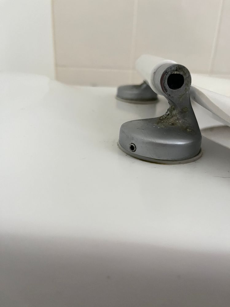

Also, the bracket that connects the lid to the seat has broken so I replace them but the seat is attached to the bowl and I can't remove it as the brackets seems to be stuck or seized (I'm using a tiny Allen key but the bracket is not budging). Do you have any suggestions?

In regards to the bracket of your toilet seat, can you please post a photo of the bracket? This will give our members a better idea of what's happening to its installation.
Thanks Eric. Pic of the bracket that holds toilet seat to bowl. Let me know if you need more pics. I've used an Allen and WD40 to try to loosen the bracket but it won't budge. Are these seat replaceable?

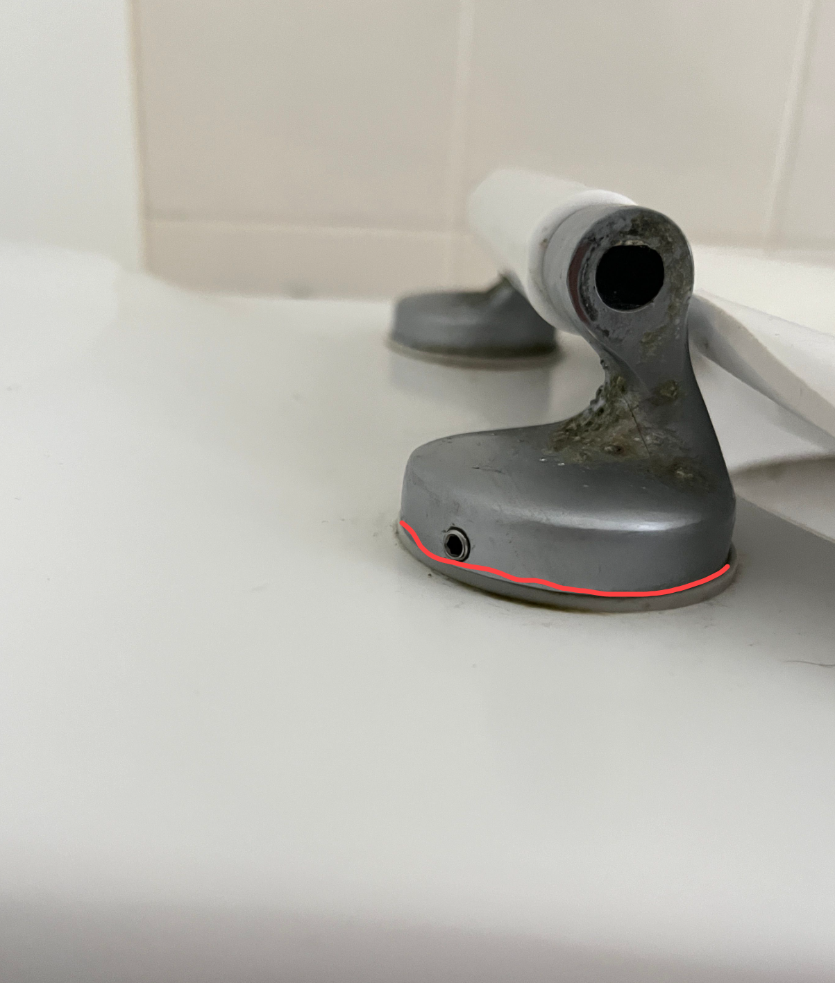

Hi @rosycal,
Is the grub screw just not budging? Or is it the bracket itself that won't lift off?
It looks like the grub screw is already loose, so it should just be a case of lifting the bracket off the base plate. If you pull upwards, can you see any separation along this seam here?
You could try using a lever such as a flathead screwdriver to pry the two pieces apart. Just be careful not to damage the toilet pan. Putting some towels or soft cloths around the location you are using the screwdriver would be a good idea.
You can replace both the seat and the brackets if they get damaged in the removal process. You would just need a new toilet seat fixing kit and a toilet seat in the correct shape and size. Check out this guide on Replacing your toilet seat for information on what to look for.

Thanks Jacob. I've now really loosened the brackets so much that I can twist them but they are really stubborn and won't lift off so I will have to persevere. I think they may have a clasp or something inside the bowl that's catching.

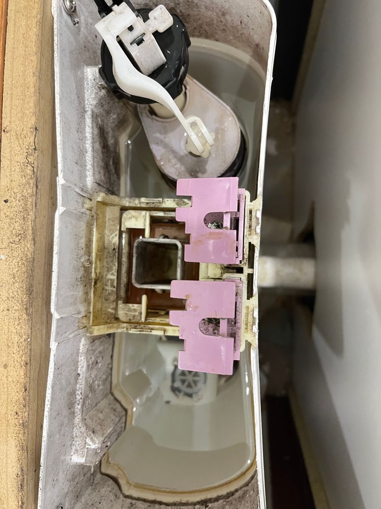

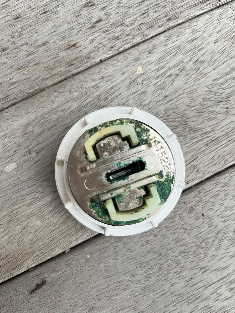

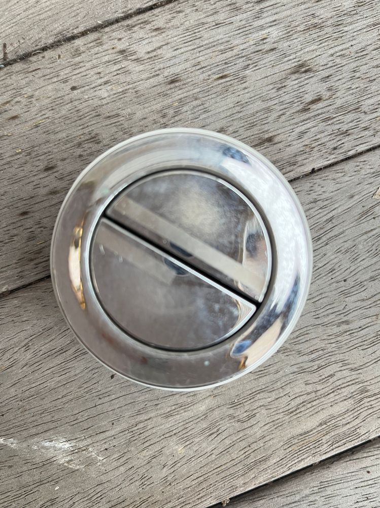

Also, the cistern & buttons are in the pics. The buttons don't connect properly with the purple valves so I can't flush unless I leave top off and push the valves manually so I'm happy to replace flushing system and buttons to fix this annoyance properly.

Hi @rosycal
Can you please post a photo of your cistern cover? I've placed a sample image of what the cover is suppose to look like along with the button configuration. The older sets have sharper corners; I've not seen this set with a round button before. Once you post the photo of the cover, I can verify for you if it is the correct one.
Thanks Eric. See pic. No lid as toilet sits under the bench with buttons inserted into the laminex. So awkward to fix.
