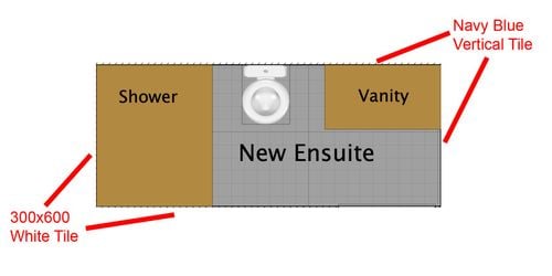

This is the bathroom layout I was thinking and which walls the tiles would go on
The cavity door is in the bottom right of this image.

I was really keen on the idea of having the top and right wall with the navy (like in the photo) and the bottom and left wall in the white. My builder has cast some doubt in my head by saying typically, you'd only make 1 wall the "feature" wall, in this case the top wall (relative to the diagram). So now I'm not sure if I would want the right wall to also be white. I worry it may take away from the look I'm going for.

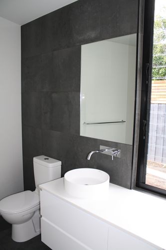

For what it's worth, here's what my wife and I did with our feature wall in our recent bathroom project, which was in a games room in our backyard (similar to a granny flat). All tiles are white except we continued the large format charcoal floor tiles up one feature wall. I tend to agree with your builder that it would be unusual to have more than one feature wall and I wonder whether the space might be too dark with no window, dark floors and two dark walls.

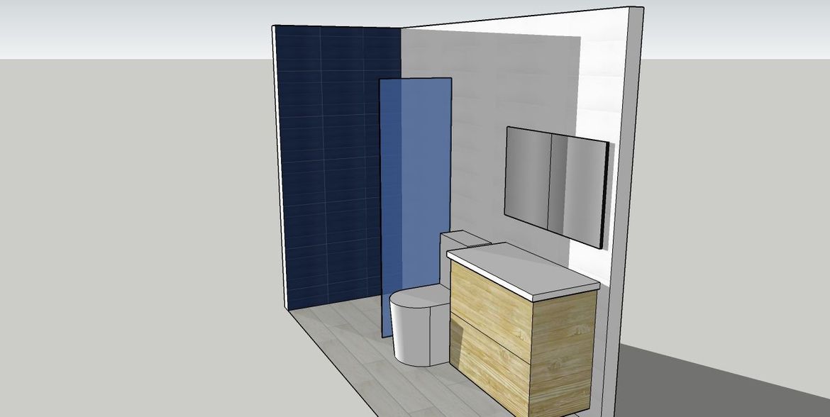

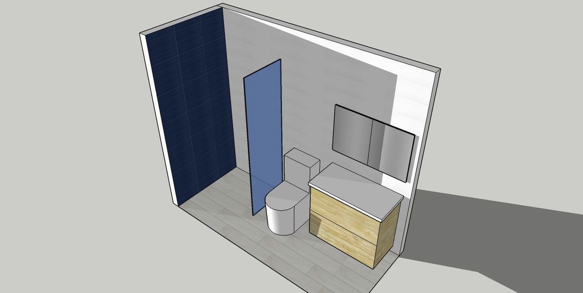

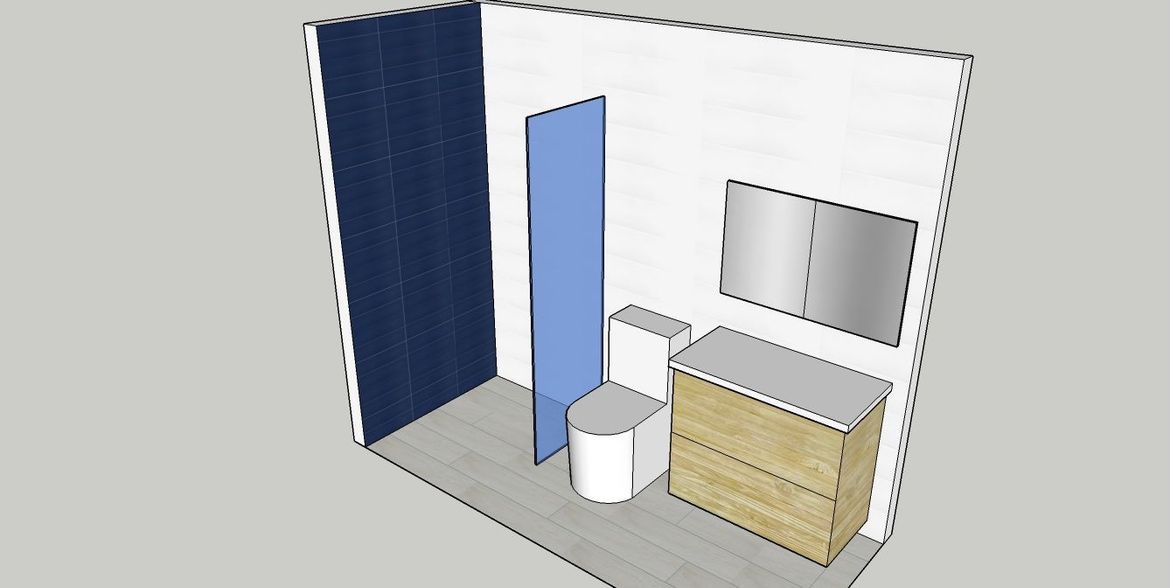

Here are a few renders. The tile colors are not 100 percent accurate but you get the idea once it has been laid out. I suggest a square skylight near your shower. This will help alleviate the darkness within the bathroom and you wont have to turn on the light all the time you have to use the loo, it will also help accent your beautiful blue matt tiles that you have chosen. If it is too dark in the room the tiles loose their effect. Your black in wall mirror cabinet will loose its impact as all you can see from it is the black edge. But if that is the effect your going for then we shall leave it as is.

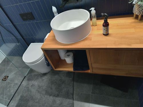

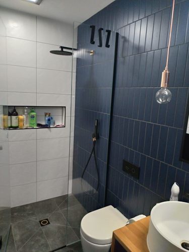

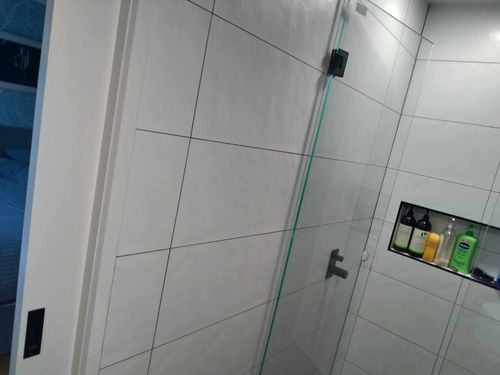

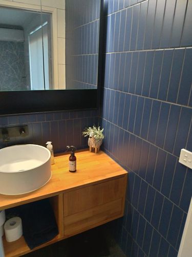

Hi All. I just realised I never did upload how it all came out. So here you go ![]()
All the fixings are from Bunnings.
We opted not to put a towel rack up as we didn't want it above the toilet, we didn't want it on the white wall, as the shower door would open in to it. So instead we bought over the door towel hangers and put them on the fixed glass panel which worked well.
The basin is from bunnings too, we got it on a clearance sale!
The vanity I made myself from 2 panels of beechwood from bunnings. The draws are the $10 cabinet draw kit from bunnings, and then just a few runners.
In hindsight though, I'd maybe recommend buying a Kaboodle drawer kit, as I had many challenges trying to align the rails on the drawer vs on the side. Even till now, it's still not perfect. But looks good enough ![]()
The measurement of the bathroom is 2.65m long x 1.1cm wide.
The toilet was the hardest piece to acquire (due to research). It is extremely slimline (doesn't protrude from the wall that much). It's only 47cm from the wall to the edge of the toilet rim. There was only one toilet this small, the Caroma Invisi Series Compact toilet suite. It has some special properties to allow for this. 1. it is obvoiusly an inwall cistern. 2. The waste pipe actual goes down into the wall as there is not enough space for a floor outlet. It has a special adapter it comes with to make a standard pipe fit the thinner pipe which can go inside a standard 90mm cavity. So there you go!
In terms of lighting, we have got a black led + fan square in ceiling fitting, a single HPF heat lamp (it's not near enough, even in this little room! I'd recommend a double lamp), an above mirror makeup light and then the little pednant with a decorative 3w globe from bunnings. This pendant is great for midnight bathroom trips without blinding you.
