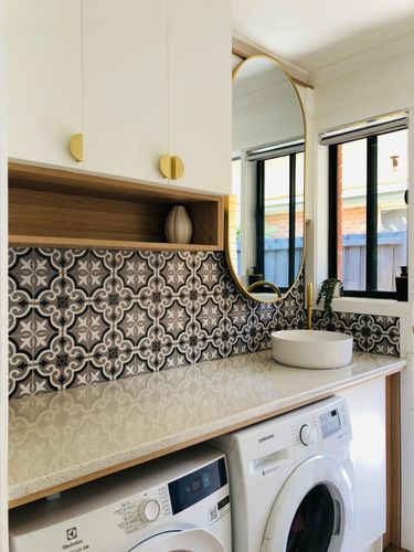

Final result

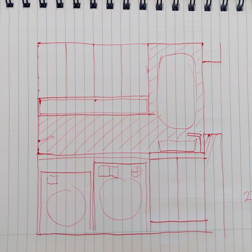

The design
We designed the laundry / powder room to maximise on wall storage as the room was only 1800mm long, which was largely the dryer and washing machine.
We also wanted to modernise the room adding some warmth and statement tiles.

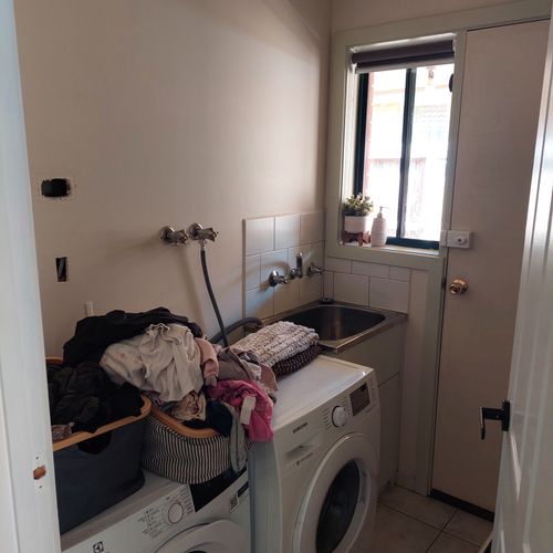

Demolition
We removed the original sink and got a plumber to move all the pluming to our preferred locations (under bench).

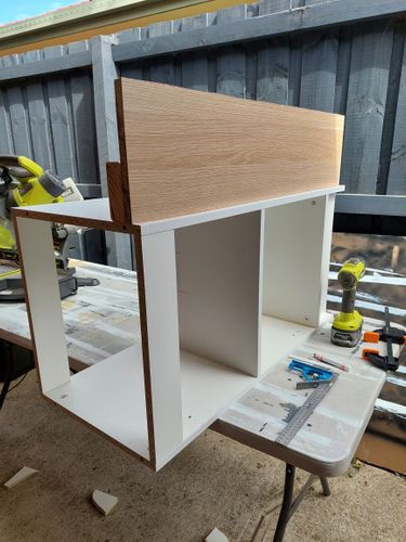

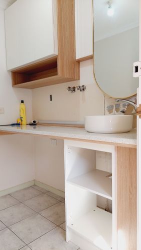

Install upper cabinets
We then installed the upper cabinets and built some custom shelving around them. We also framed a portion on the wall above the sink area and installed some VJ panels for some depth and texture.
Step 4
Install lower cabinet  
We then installed the laminate benchtop and the bottom 450mm cabinet with a timber panel as a feature

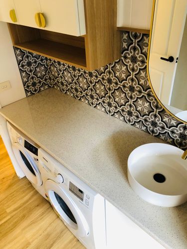

Step 5
Flooring
We then installed the vinyl flooring planks over the existing tiles. 
Step 6

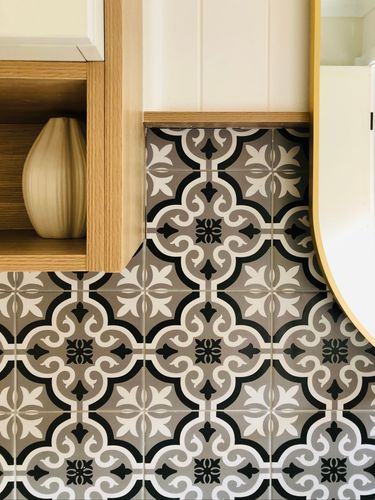

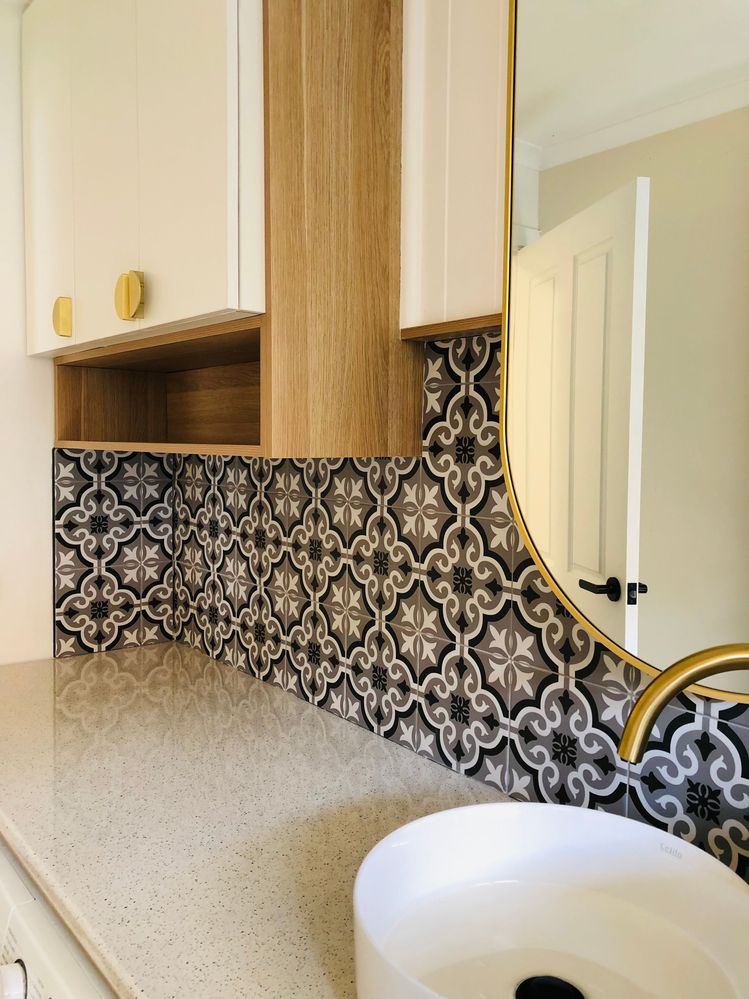

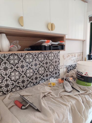

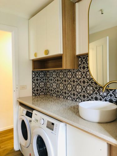

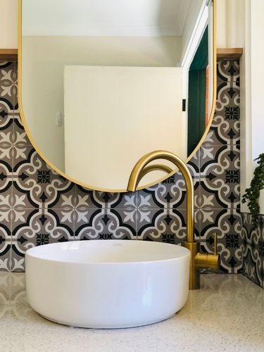

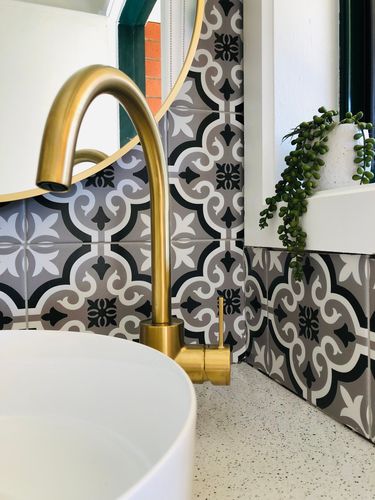

Tiling
I then completes the tiling.

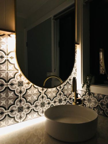

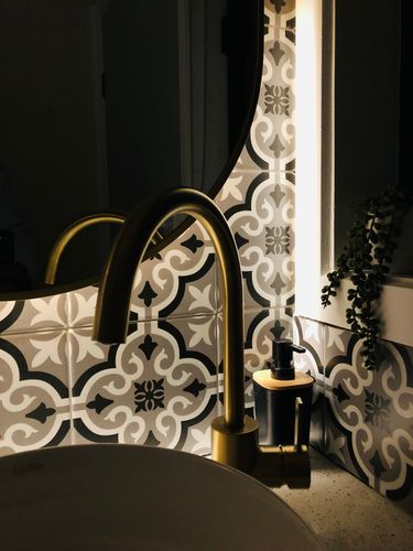

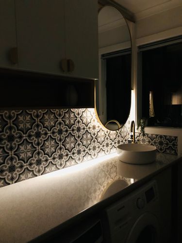

Lighting
We then installed some rechargeable strip lighting behind the mirror to add some ambiance to the room.
