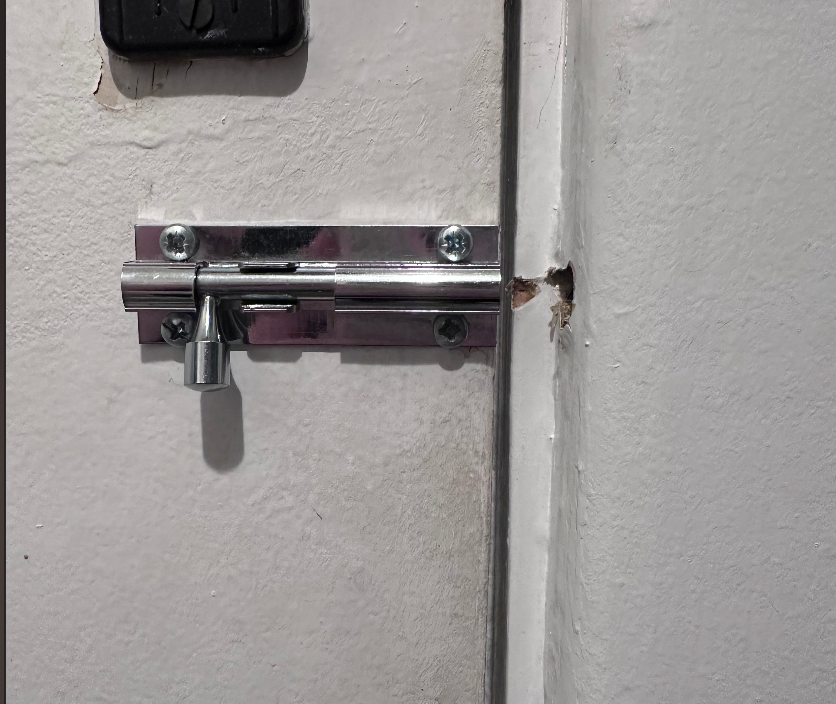

So, I need a solution to my dilemma
I have installed one part of the lock, I drilled a hole for the latch thing to go into. However the lock isn't long enough to go into the hole. So when you've "locked it" the door will still be open.
What do you suggest I use to fix it?
I know I've done a terrible job! Please don't judge!!!

I propose getting a piece of timber about 60mm long, 25mmwide and 10mm thick and placing it in front of the lock. The piece of wood will need to be glued and screwed next to the door frame and into the wall for a firm installation. I suggest using Selleys liquid nails to attach it to the wall. Once it is in place you can then drill a hole into it for the bolt on the door to slide through. This will prevent the door from opening. The timber patch can be painted over so that it matches the colour of your wall.
Let me call on our experienced members @Dave-1, @Noyade and @Nailbag for their recommendations.

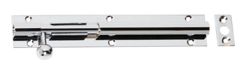

I am wondering if the workshop lads can find one like that with a long throw bolt.
I'll also have a look and come back...
