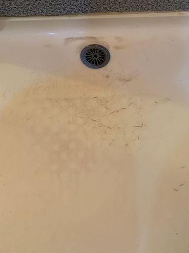

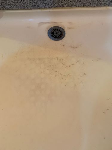

hi I need a bit of advice
I want to paint my shower base but am not quite sure what it is made of
it would be about 30 years old if not more
can I use White Knight tub and basin paint on it
as you can see by picture it is in pretty bad condition
replacing it is not an option
can anyone help

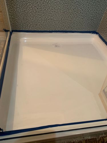

Re: painting a shower base
@WendyJane
Shower all finished  not completely perfect but 100 percent better than what it was just wish I  had time to give it a third coat but paint is only viable for 36 hours I even painted the drain which was cromeand pretty rusty used metal rust proof paint and it came up really good
