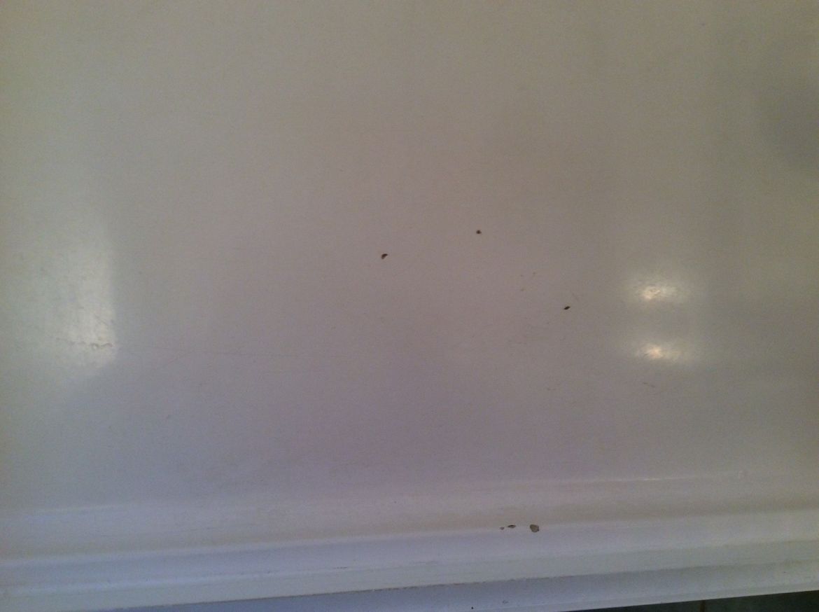

Hi Eric, I haven't done this yet or purchased the products, I did upload the photos I think?

@EricL,
They are both whiter than shown.

Hi @KARINA,
@EricL will be back on the site after the weekend, and I trust he will be keen to continue the discussion with you. As per Eric's advice, you could use the putty to fill the chips. That "white" will actually turn out a greyish colour, and your chips will still be noticeable, so you'll likely have to touch those repairs up with some white epoxy enamel paint.
Your second image shows crazing to the glaze, which are very fine crack lines. I don't believe you'll be able to fill those necessarily. As mentioned, that putty is grey, and even if you could fill them, I don't think you'll see much of an improvement.
You might like to consider painting the basin with White Knight 500ml White Tub And Basin Paint. I've used this product in my basin and bathtub and was impressed with the results. My bathtub and basin were pink, and it covered that very well. After around three years, it's still in great condition.
