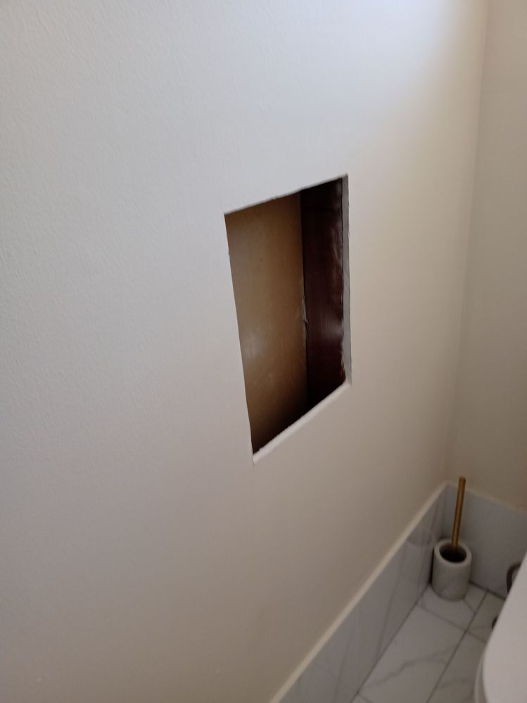

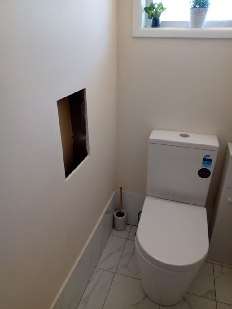

Step 1
Cut hole into wall to find placement of studs. This will determine the size of the recess you can make (distance between studs). We have an older home so the distance (width) can be a bit variable

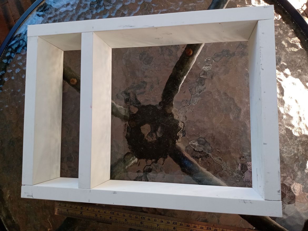

Step 2
Make the frame to the determined size of the recess. Add the backing sheet. Fill holes with putty and sand.

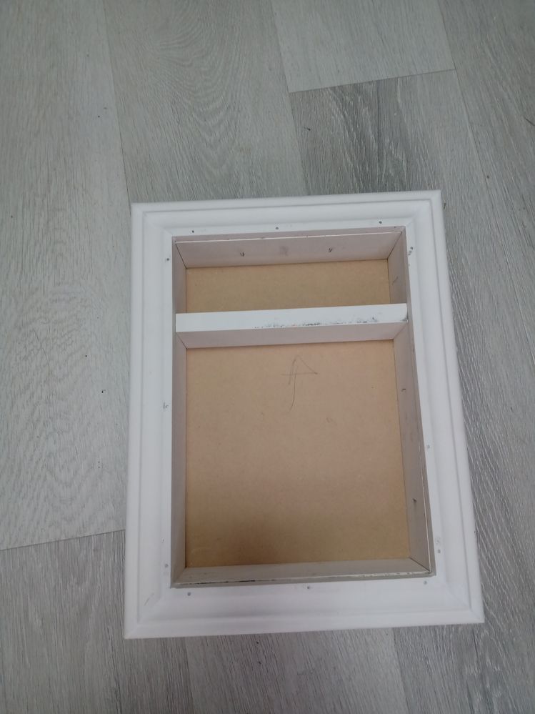

The frame
Backing added

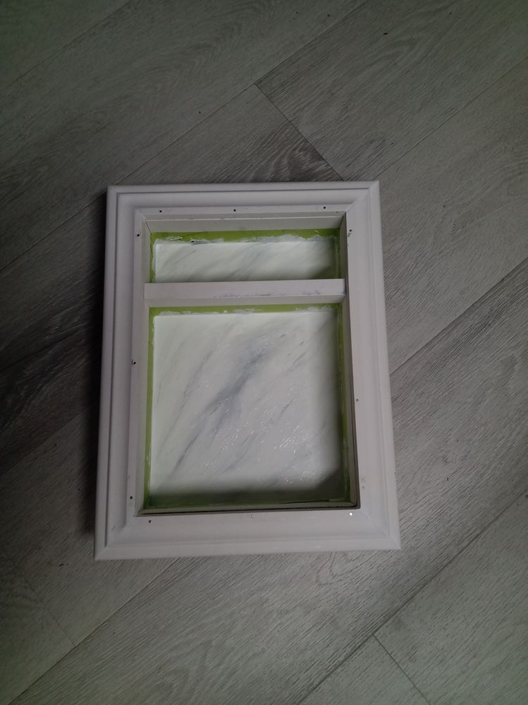

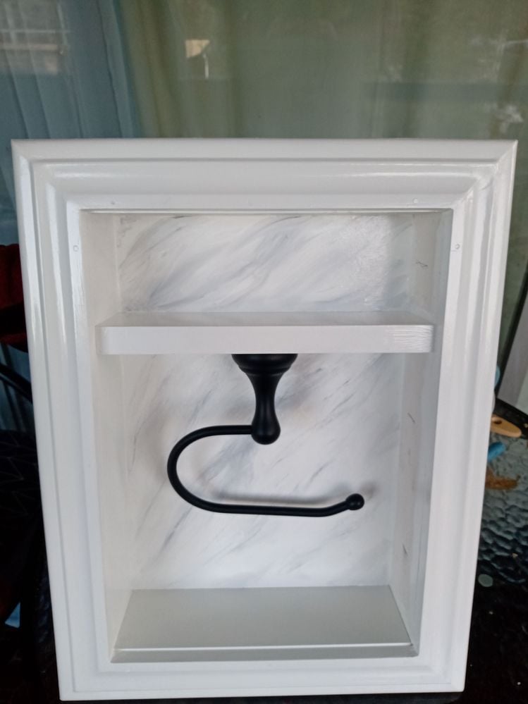

Step 3
Paint the frame white. Add marble effect to the back if desired.
Step 4
Add the toilet roll holder.

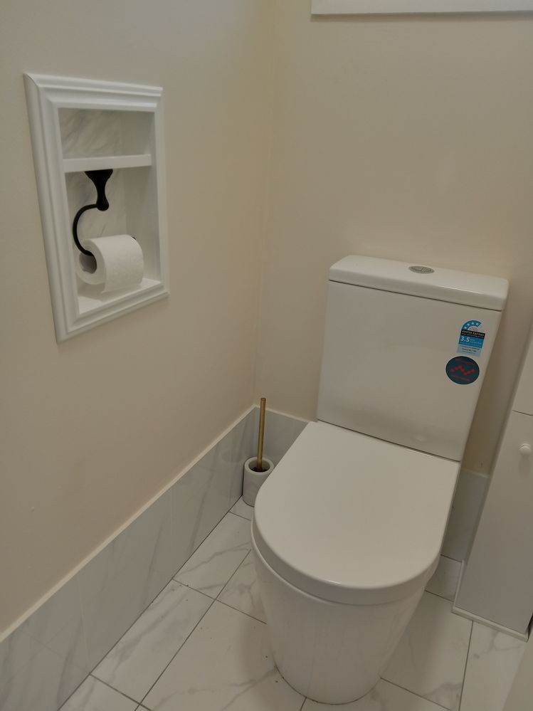

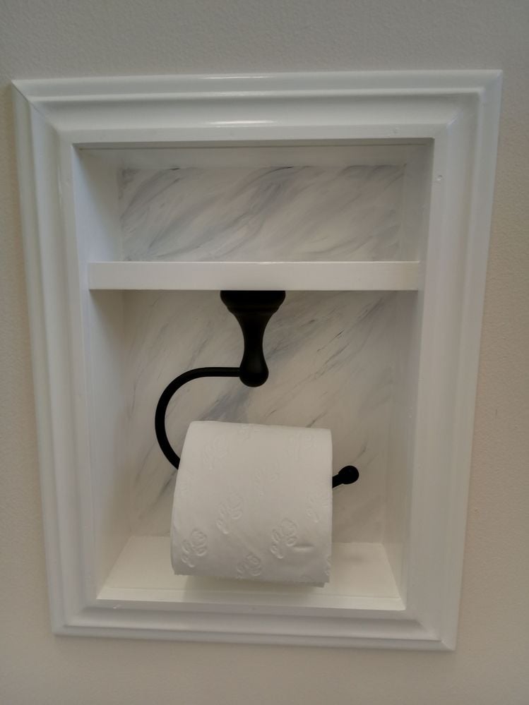

Step 5
Mount into wall and secure to studs with screws (counter sunk). Fill holes, sand and touch-up with paint.
