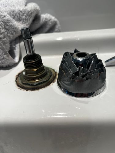

Any ideas how to get this tap bonnet off?
Hi everyone, the tap set installed across our house is my nemesis. If I had the money I would replace them all with something I could easily take on and off.
Right now I’m struggling to unscrew this tap bonnet. I’m certain I’m screwing it the correct way and I’ve managed to get a paint scraper in between the bonnet and the tiles. I think the thread is just stuck and I can’t grip it well enough to force it to turn because of the design.
Any help would be MASSIVELY appreciated. 🙏🏻

I tried the rubber glove, scraper, hot/cold water, WD40 and the rubber strap clamp. All to no avail (arguably, these all helped...). I got my reciprocating saw (without blade) and pushed the foot (or shoe) against bonnet and vibrated the daylights out of it. Similar to the tap-tap-tap approach with the hammer, this worked a treat.

I managed to get the strap wrench to work by winding on thin strips of Gorilla tape so that the strap could get a hold without slipping

Thank you for sharing your knowledge and experience in regards to bonnet removal. What a clever idea, the tape provides both grip and mass to anchor onto to allow you to properly grip and turn the bonnet! This has to be one of the most non-destructive methods I've seen to anchor and turn the bonnet.
