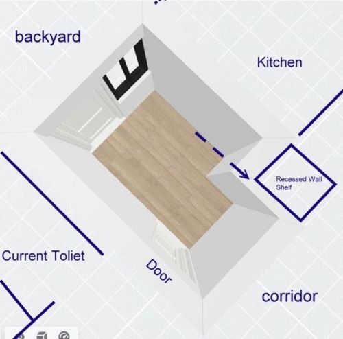

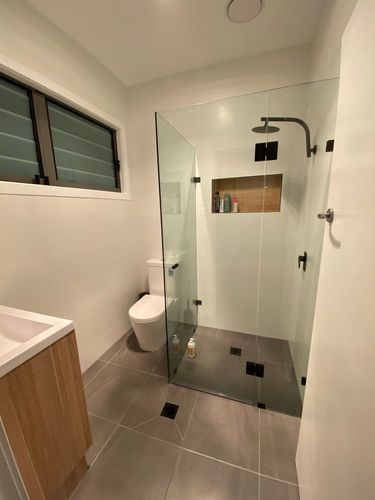

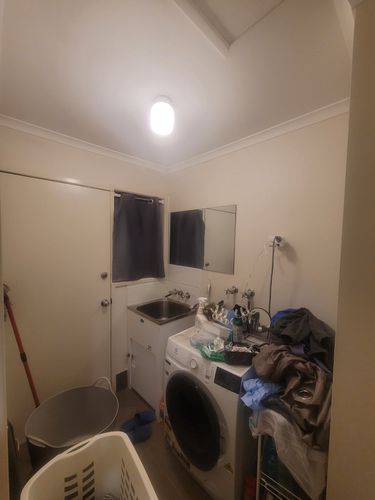

This is our laundry room, and we want to convert it into a bathroom with toliet.

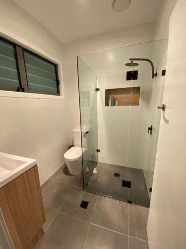

We want the result to look like this:
(https://www.workshop.bunnings.com.au/t5/Featured-Projects/Classic-bathroom-renovation/ta-p/76907)
Our question is what order of work we should do / hire people to do ?
Hi @ivanptr,
If you haven't already done so, you might like to read through this helpful guide: How to plan a bathroom renovation.
Your plan of attack sounds good, but I'd be looking at having the electrical and plumbing work done before plastering the walls. Those will be much easier to do for the professionals without the plasterboard in place. Once it's done, you can close up the walls with plasterboard.
The steps you hire people to do will come down to your skillset and what you are comfortable doing yourself. As you've mentioned, the demolition stage is likely something you could achieve, and you might like to consider doing the tiling, plasterboard and installing the vanity yourself. I'd recommend leaving the enclosing of the door and window, waterproofing and shower screen installation to the professionals. Obviously, they'd be doing the electrical and plumbing, too.

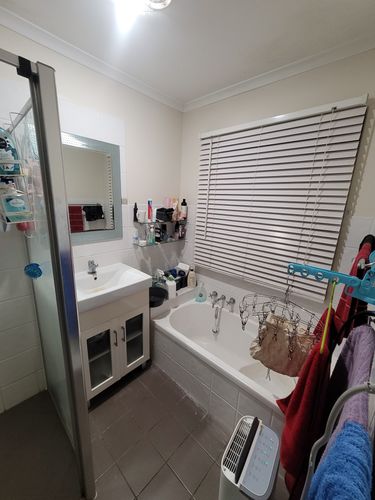

1) Removing the bath from our bathroom since we only use shower anyway. Havent used the bath for AGES! Then with the extra space in our bathroom , we can install a 2nd toliet.

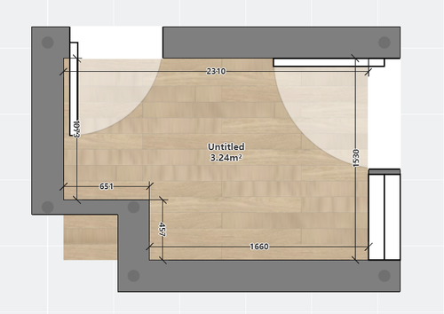

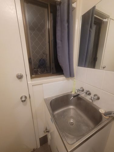

-> Though we are struggling to decide where we should install our 1) window , 2 ) shower in the laundry room
Window:
The only single wall that we can install the window on is the one facing the backyard. Does that mean we better keep the current window? But would it be difficult to waterproof this old window?
or we better replace it with some kind of bathroom window and instruct the professionals to install the new window when they do the enclosing?
Any suggestion? 🤔
The measurement and layout of the laundry room attached in the first post of this thread.
-> Any tools / technique you can recommend and share on how to remove the bath from our bathroom ?
We want to remove this bath ourselves this weekend, Before asking the plumber to come and install the toliet for us.

I don't think there is any issue with installing a window that faces the backyard @ivanptr; blinds or frosting can be added for privacy. Depending on how close the old window will be to the shower, waterproofing it might only require an additional coat of paint. Make sure that you have good ventilation and exhaust fans in the new bathroom. Some positions for the shower would include the red, green and blue squares I've placed on your plan below.

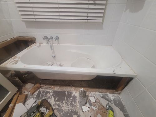

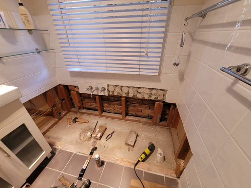

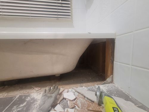

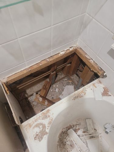

Got the tools this afternoon
But after 3 hours we still cant take bath out🤦🏻🌝

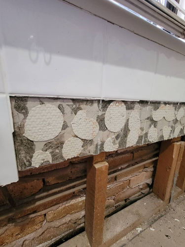

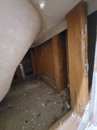

it seems the bath is attached to 1) the floor through the drain and 2) the wall?
Any idea how to remove it ?
Do we have to remove more tiles?
We tried to break the bath in pieces with hammer but its some kind of plastic very difficult to break.
Drain connection👆?

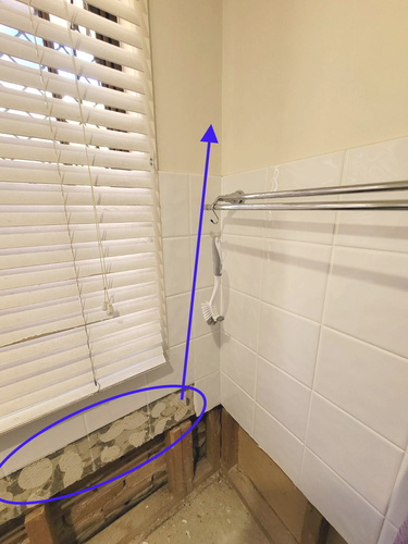

Great progress, @ivanptr!
You'll need to disconnect the drain waste. Cutting through the waste pipe with a timber saw might be easiest.
Next, start cutting away those upright lengths of timbers that are supporting the bath, not the wall studs. You might find the bath has a bead of silicone between it and the tiles. Cut through this with a utility knife. Then, get that prybar under the lip of the bath and lever it up away from the supporting frame at the back. It could have been glued to the timber frame, so you might need to cut through it or lever the frame off the wall studs.

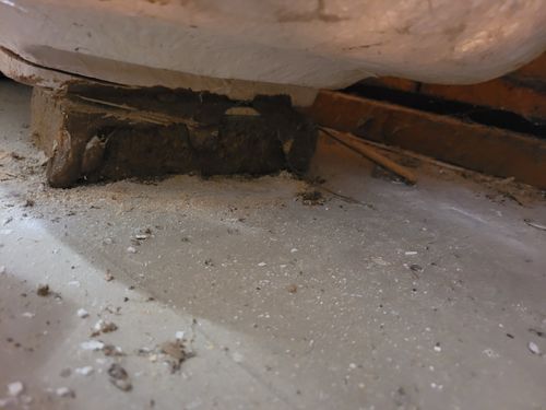

Update : Solved
We managed to use hammer drill to break the adhesion between the brick and bottom of bath.

We've just realized its glued to two bricks
very difficult to cut through the adhesion between the brick and bath using handsaw🥲
any plan to attack this?

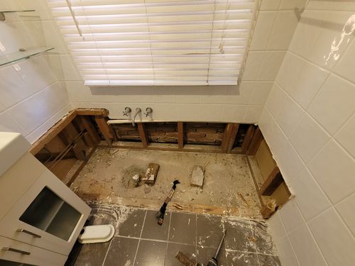

After using a lot of beginners elbow grease , we finally removed that bulky bath off !
tons of sense of satisfaction 🌝
But we still have some follow-up questions before proceeding. Gonna take a short break and organize our thought first. Keep in touch. Have a nice weekend.

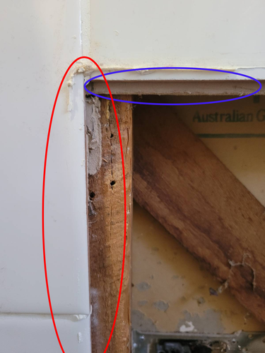

We have been finding information on internet but still trying to wrap our head around 3 challenges:
1) The concrete floor is 3.5 cm lower than the tile surface. Seems a lot. Even we install new tiles (following this clip: https://www.youtube.com/watch?v=40GdJa5WU-U) , the level will still be much lower than the existing tile floor ? how should we prep the concrete surface before tiling? :
2) After taking out the tiles, how can we restore the surface back to plastered wall? or prep the surface for re-tiling?
3. In our understanding, there are 2 steps in installing new bathroom wall :
Step 1) Screw the villaboard to the stub
https://www.youtube.com/watch?v=c5NQesRDpG8
2) Stop up villaboard joints
https://www.youtube.com/watch?v=-lsIG5Km-4E
But the vertical part (adjacent old villaboard is not exposed) , how could we stop up the joint between the old and new villaboard?
